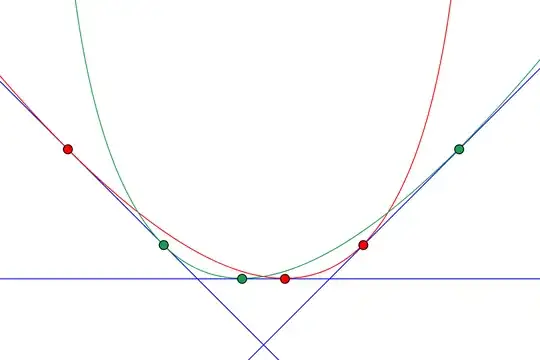

  • @Piquito Two parabolas can have an additional exterior common tangent once you skew the axes e.g. this. – dxiv Nov 12 '16 at 01:55

Here is one example, constructed in Cinderella as a pair of conics defined by five lines each, with four of the lines in common, and one of these four located at infinity.
Example
