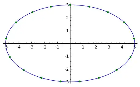

Here is an example for $a=5, b=3, n=17$:
Example
$$\begin{array}{rccccc} k & \varphi & x & y & \theta \\\hline 0 & 0.0000000 & +0.0000000 & +3.0000000 & 0.0000000 \\ 1 & 0.3032641 & +1.4931847 & +2.8631004 & 0.4807207 \\ 2 & 0.6256782 & +2.9282358 & +2.4316983 & 0.8777733 \\ 3 & 0.9945508 & +4.1925715 & +1.6346388 & 1.1990363 \\ 4 & 1.4462325 & +4.9612598 & +0.3727257 & 1.4958100 \\ 5 & 1.9329168 & +4.6757386 & -1.0627741 & 1.7942945 \\ 6 & 2.3395668 & +3.5938304 & -2.0857560 & 2.0966579 \\ 7 & 2.6809206 & +2.2227512 & -2.6872618 & 2.4505185 \\ 8 & 2.9910709 & +0.7497699 & -2.9660789 & 2.8939978 \\ 9 & 3.2921144 & -0.7497699 & -2.9660789 & 3.3891875 \\ 10 & 3.6022648 & -2.2227512 & -2.6872618 & 3.8326668 \\ 11 & 3.9436185 & -3.5938304 & -2.0857560 & 4.1865274 \\ 12 & 4.3502685 & -4.6757386 & -1.0627741 & 4.4888908 \\ 13 & 4.8369528 & -4.9612598 & +0.3727257 & 4.7873754 \\ 14 & 5.2886345 & -4.1925715 & +1.6346388 & 5.0841490 \\ 15 & 5.6575071 & -2.9282358 & +2.4316983 & 5.4054121 \\ 16 & 5.9799212 & -1.4931847 & +2.8631004 & 5.8024646 \end{array}$$

  • Hi, is it an optical illusion or do I missunderstand the Q/A. When I increase n, the pointdensity close to the x axis is higher. – ramin Oct 13 '17 at 15:25
  • In the table of values shouldn't the φ values be 2π/17*k? For k=1 I get: 0.3695991 How did you get those values? – Buzz Oct 19 '22 at 23:25
  • I just realized your plotted ellipse "sits flat" because of it's points: 0.7497699, -2.9660789 -0.7497699, -2.9660789 I guess that's why your φ values are all shifted? To make a more pretty ellipse? – Buzz Oct 19 '22 at 23:36
  • @Buzz The $\varphi$ come from solving $\tfrac knc=a,E(\varphi|m)$ as described in my answer. If you go for equidistant amplitude you don't get equidistant arc length. – MvG Oct 20 '22 at 07:39
