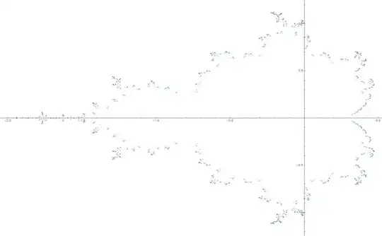

I have noticed some interesting properties of Mandelbrot series that lead to a different way to plot the M-Set to elucidates certain details and properties. The 17,723 points in the graphic below all lie exactly on the edge of the M-Set.

MandelEdges
The Mathematica code below generates a set of polynomials $\{u_{mn}\}$ where $z$ is $(m-n)$-periodic at $c$ from $n$ iff $u_{mn}(c)\equiv 0$. The roots for $n>0$ (M-set edges) are then calculated numerically and plotted.
I break the $z$ polynomials down into $\{u_{mn}\}$ polynomials in order to reduce as much as possible the order of polynomials that need to be solved numerically. For example, to calculate the $c$'s that are 3-periodic from 5, we would find them within the roots of $z_{8}(c)-z_{5}(c)$ but that set will also contain all the roots of $\{z_{7}-z_{4},z_{6}-z_{3},z_{5}-z_{2},z_{4}-z_{1},z_{3}-z_{0},z_{6}-z_{5},z_{5}-z_{4},z_{4}-z_{3},z_{3}-z_{2},z_{2}-z_{1},z_{1}-z_{0}\}$ so clearly, strategic factoring of the $z$ polynomials into u's and eliminating redundant root-finding saves significant time.
Question: Could the $u$ polynomials be analytically factored down further?
Question: Are there other properties of M-set edge points that would allow us to find more without huge computational cost?

These settings will produce a plot in few seconds. The jpeg above took a while and was generated with
ord=11;
plotOrd=11;
and
Print[ListPlot[Transpose[{Re[rts], Im[rts]}],PlotStyle ->PointSize[Tiny]]];
It's also interesting the plot the roots of one u[m,n] at a time and observe where they end up and how the shape of the M-set emerges a m increases--especially around the crevice near c=1/4.

    Your $p$-periodic points are known as strictly pre-periodic points or Misiurewicz points. And, yes, the fact that they are dense in the boundary is fundamental. – Mark McClure Dec 15 '15 at 01:44
  • @MarkMcClure Ah, thank you. I see a lot of questions like this one here and elsewhere where people want to know about interesting M-set properties that a pre-Calc student could understand, but I've never seen Misiurewcz points mentioned before. – Jerry Guern Dec 15 '15 at 01:53
