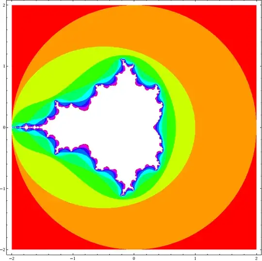

That being said, there are a number of results that are certainly accessible without topology or complex analysis. The first of which was referenced in the comments, that $M$ is bounded by the circle of radius 2.
Notice that M is bounded by the orange circle
This is quite easy to prove, although not quite "trivial". You should definitely be able to manage it by yourself if you haven't already. Simply think of where $f_c$ sends $0$ after the first iteration.

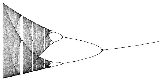

But don't stop there! There are plenty of other cool geometrical things on $M$ that don't require particularly complicated machinery. For example: if you read a little about bifurcation diagrams, specifically for $x^2 +c$ with $c \in \Bbb{R}$, you'll understand a little bit about chaos theory, and understand this diagram:
Bifurcation diagram

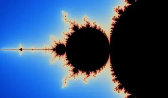

But this is the exact same function as generates the Mandelbrot set. So if you look at the negative real axis of M you should see a striking similarity:
negative real mandelbrot
And this knowledge of at least some of the structure of the Mandelbrot set comes only from the study of one very simple dynamic system, which you can analyse using only algebra and perhaps a little calculus. Fully understanding bifurcation theory does require a lot of work, but that isn't necessary to understand this one simple connection.
