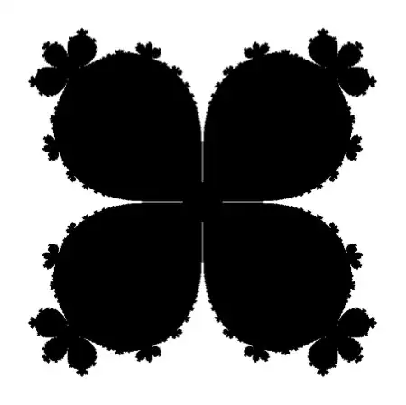

In the first case, we are certain that $z_0$ lies outside the filled Julia set - we shade the point white. In the second case, we strongly suspect that $z_0$ is in the filled Julia set, but we're not certain as we might just not have iterated enough. We shade the point black.
If we perform this procedure for a dense grid of points in a rectangular domain of the complex plane, then we generate an approximate image of the filled Julia set - the higher the bailout and the more dense the set of points, the better the approximation. This simple strategy is very easy to implement. Here's a $500\times500$ image using a bailout of 2000 on the iteration count:

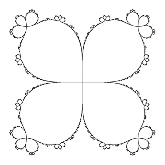

There is a standard way to detect the boundary between the two regions to yield the actual Julia set. Unfortunately, it is not particularly impressive at this resolution:

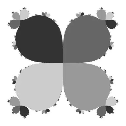

We can describe the more clever classification scheme in the context of this example easily enough. Suppose we iterate $f(z)=z+z^5$ only 100 times. It turns out that most iterates have either exceeded 2 in absolute value, or they have landed in one of the four prominent leafs attached to the origin. We shade points that escaped white and the remaining points according which of the quadrants the point has landed in. The result looks like so:
If we then apply the boundary scanning technique to this, we get the first image above.
