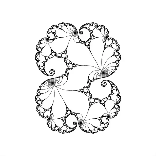

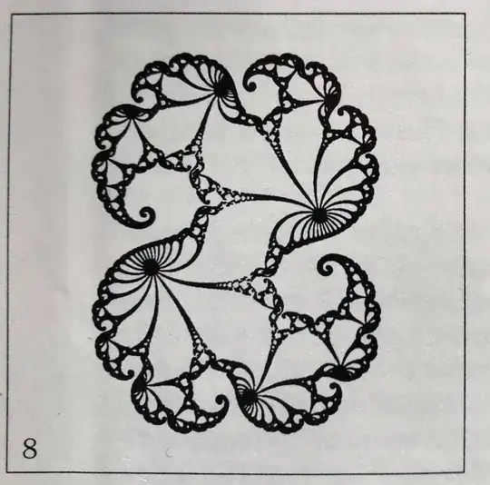

The image from "The Beauty of Fractals" is a complex number Julia set from the equation Zₓ₊₁ = Zₓ² + C. The Julia seed point is .27334, .00742i. The image from the book looks like this:
Note the complex, connected interior structure.

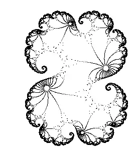

The JavaScript app recommended in the answer looks like this:
Note how the interior structure is faint and does not connect like the image from the book.

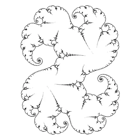

The best I can do with my app is to plot the Julia set using Distance Estimates and crank up the boundary I draw:

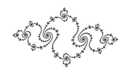

Here's a comparison of those two algorithms for $z^2 - 0.77967939051932 + 0.11124251677182495i$:
Inverse iteration
Boundary scanning

  • That JavaScript web app does a little better than my app at finding the fine structure of Julia set boundaries, but not nearly as good as the images in The Beauty of Fractals. The point 12 from preface page XII has the coordinates 0.27334,0.00742i. In B of F, the image shows the interior "tendrils" of the Julia set really clearly. The IIM image from the web app does't capture nearly as much detail. – Duncan C Dec 22 '19 at 20:31
  • @DuncanC I don't have the text handy but high resolution images in those texts are generally generated with boundary scanning. I've attached a couple of images to illustrate. – Mark McClure Dec 23 '19 at 16:03
  • See the edit to my question. I included the coordinates of the image I'm using as a test case, along with a photo taken from the book, the image generated by the JavaScript app, and the best my app is able to do using Distance Estimate (DE) data. – Duncan C Dec 23 '19 at 21:18

BTW, image from the book is a parabolic Julia set, example images and code you can find here
