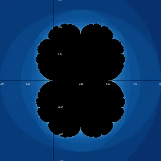

Mathematica can plot the image of Julia set for an arbitrary polynomial, or even a more or less arbitrary rational function, for that matter. That's ultimately how WolframAlpha works.
Another option is this web page. Just enter the list of coefficients and (optionally) a bounding rectangle. Here's the resulting image:
Finally, the Julia set of any quadratic is geometrically similar to some function of the form $z^2+c$. This particular one is similar to the Julia set of $z^2+1/4$. So you could always just plot that, then rotate, scale, and shift.
Mark McClure
  • 31,496
  • Thanks for your answer! This site is exactly what I was looking for and pretty cool. I just have one last question. If I see this right, the "black set" is the Fatou set and near the boundary and the "blue set" is the julia set? And what are the different blue shades indicating? Thanks! – deavor May 19 '17 at 13:31
    The black set is sometimes called the "filled Julia set". If the iteration starts anywhere in the interior of the black set, it will converge slowly to the neutral fixed point zero. If you start anywhere in the blue region, the iteration will diverge to $\infty$. The shading indicates how many iterates until the absolute value exceeds some escape radius; the program happens to choose 4 for this particular polynomial. Taken together, the black region and the blue region form the Fatou set for this polynomial. The Julia set is the boundary between these two regions. – Mark McClure May 19 '17 at 13:38

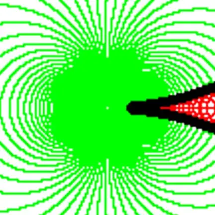

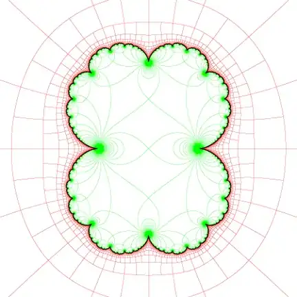

Updated to add, I wrote a C99 program that renders the Julia set using edge-detection of level sets, coloured for low-ink printing. Here's the output:
Julia set for $z-z^2$
A closeup reveals the accuracy problem with this method: the Julia set (in black) is not drawn extending all the way to the parabolic point at the center of the green blob as it should be:
detail of Julia set, revealing flaws
This is mostly because the gap gets very thin for a significant length, aligning the sampling grid to the gaps can fix it for some (pre-)parabolic points (for example at the 4 biggest green blobs aligned to the axes), but not for all of them at once.

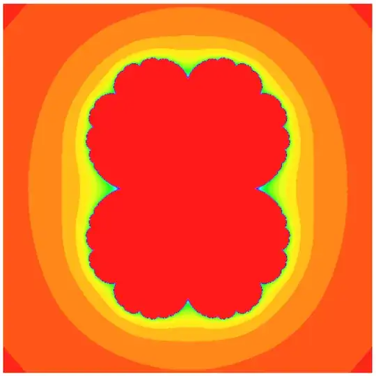

Since you mentioned Maple, here are two ways in that product.
The faster way, available in recent Maple versions, is to use the IterativeMaps:-Escape command. That produces a hardware double-precision m-by-n-by-3 Maple Array representing an image in RGB format, which can be exported to an image file in several standard formats. (I used ImageTools:-Write to export it to .png format.)
CodeTools:-Usage reports "cpu time" as cumulative in all threads used here. I ran it on a 4-core Linux machine. The reported "real time" is the wall-clock time.
restart;
with(IterativeMaps):
form := z - z^2;
                           form := -z  + z
z := subs(z=zr+zi*I, form):
fzi := evalc( Im( z ) );
                        fzi := -2 zi zr + zi
fzr := evalc( Re( subs(zi=zitemp, z) ) );
                                   2     2
                      fzr := zitemp  - zr  + zr
julia_img := CodeTools:-Usage(
    Escape( [zi  , zr  , zitemp , zrsqr , zisqr],
            [fzi , fzr , zi     , zr^2  , zi^2 ],
            [y   , x   , y      , x^2   , y^2  ],
            zrsqr+zisqr > 250,
            -1.0, 2.0, -1.5, 1.5,
            iterations = 30,
            height=600, width=600 ) ):
    memory used=20.41MiB, alloc change=46.80MiB, cpu time=656.00ms,
    real time=285.00ms, gc time=0ns
with(ImageTools):
FitIntensity(julia_img, inplace):
Embed(julia_img);

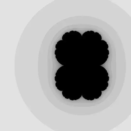

A slower way, possible in even much older Maple versions, is to compute a density plot. I've computed both this and the above image at 600-by-600 resolution, to give an idea of the relative performance.
restart;
form := z - z^2;
                        -z  + z
update := op(evalc([Re,Im](subs(z=re+im*I, form))));
                           2     2
               update := im  - re  + re, -2 im re + im
JuliaSet := subs(__dummy=update,
  proc(a, b)
    local re, im, resq, imsq, m;
    (re, im) := (a, b):
    resq := re^2:
    imsq := im^2;
    for m to 30 while resq+imsq < 250 do
      (re,im) := __dummy;
      resq := re^2;
      imsq := im^2;
    end do;
    return m;
  end proc):
CodeTools:-Usage(
  plots:-densityplot(JuliaSet, -1.0..2.0, -1.5..1.5,
                     colorstyle=HUE, grid=[600, 600],
                     style=patchnogrid, axes=none,
                     size=[600,600]) );
    memory used=4.93GiB, alloc change=8.24MiB, cpu time=25.88s,
    real time=25.90s, gc time=5.32s
Adjusting the iteration limits, or the escape cut-off value, will change the coloration, naturally.

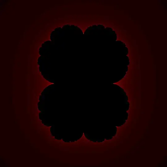

I just finished the programm. Remember, this is neither efficient nor user friendly. But it draws. If you want, you can download it here: http://www.mediafire.com/file/7u25p9gcl7cgfh4/JuliaLSM.exe
Your julia set looks like this:
julia set for -z² + z
The viewing window is $-2$ to $2$ on both $x$ and $y$. This image was created by the "Level-Set-Method" or short LSM. If you iterate $f(z) = -z^2 + z$, the magnitude of $z$ may blow up or may not blow up. If you plot the values of $z$ for which the magnitude didn't blew up in black, you obtain this picture. I have added a color gradient to indicate how fast / when the blow up happend.
This is what you may call a "filled julia set".
The real julia-set is only the border between the black thing and the rest.
Interestingly, this is quite similar to the julia-set of $f(z) = z^2 + 1/4$, but shifted to the right.
(Sorry if I made spelling or grammar mistakes, English is not my native language.)
