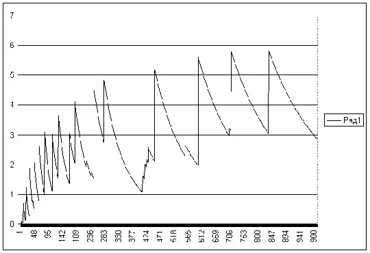

Update. I wrote a program which provides a bound $g(n)\ge f(n)$ starting from $a_1=1$ and greedily taking by $a_n$ the smallest natural number such that all values $1/a_i+1/a_j-1/a_k-1/a_n$ for $1\le i,j,k<n$ are non-zero. See the graph of $g(n)/n^4$ for $2\le n\le 1000$.
