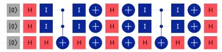

Following is a manual step-wise computation of the 2 qubit Grover algorithm circuit for finding $|00\rangle$:
Step 1:
$$|00\rangle$$
Step 2:
$$\frac{1}{\sqrt2}(|0\rangle + |1\rangle)\frac{1}{\sqrt2}(|0\rangle + |1\rangle)$$ $$=\frac{1}{2}(|00\rangle + |01\rangle + |10\rangle + |11\rangle)$$
Step 3:
$$\frac{1}{2}(|11\rangle + |10\rangle + |01\rangle + |00\rangle)$$
Step 4:
$$\frac{1}{2}(|1\rangle\frac{1}{\sqrt2}(|0\rangle - |1\rangle) + |1\rangle\frac{1}{\sqrt2}(|0\rangle + |1\rangle) + |0\rangle\frac{1}{\sqrt2}(|0\rangle - |1\rangle) + |0\rangle\frac{1}{\sqrt2}(|0\rangle + |1\rangle)) $$ $$=\frac{1}{2\sqrt2}(|10\rangle - |11\rangle + |10\rangle + |11\rangle + |00\rangle - |01\rangle + |00\rangle + |01\rangle) $$
$$=\frac{1}{\sqrt2}(|00\rangle + |10\rangle)$$
Step 5:
$$\frac{1}{\sqrt2}(|00\rangle + |11\rangle)$$
Step 6:
$$\frac{1}{\sqrt2}(|0\rangle\frac{1}{\sqrt2}(|0\rangle + |1\rangle) + |1\rangle\frac{1}{\sqrt2}(|0\rangle - |1\rangle))$$
$$=\frac{1}{2}(|00\rangle + |01\rangle + |10\rangle - |11\rangle)$$
Step 7:
$$\frac{1}{2}(|11\rangle + |10\rangle + |01\rangle - |00\rangle)$$
Step 8:
$$\frac{1}{2}(\frac{1}{\sqrt2}(|0\rangle - |1\rangle)\frac{1}{\sqrt2}(|0\rangle - |1\rangle) - \frac{1}{\sqrt2}(|0\rangle - |1\rangle)\frac{1}{\sqrt2}(|0\rangle + |1\rangle) + \frac{1}{\sqrt2}(|0\rangle + |1\rangle)\frac{1}{\sqrt2}(|0\rangle - |1\rangle) - \frac{1}{\sqrt2}(|0\rangle + |1\rangle)\frac{1}{\sqrt2}(|0\rangle + |1\rangle))$$
$$=\frac{1}{4}((|0\rangle - |1\rangle)(|0\rangle - |1\rangle) + (|0\rangle - |1\rangle)(|0\rangle + |1\rangle) + (|0\rangle + |1\rangle)(|0\rangle - |1\rangle) - (|0\rangle + |1\rangle)(|0\rangle + |1\rangle))$$
$$=\frac{1}{4}(|00\rangle - |01\rangle - |10\rangle + |11\rangle + |00\rangle + |01\rangle - |10\rangle - |11\rangle + |00\rangle - |01\rangle + |10\rangle - |11\rangle - |00\rangle - |01\rangle - |10\rangle - |11\rangle)$$
$$ = \frac{1}{2}(|00\rangle - |01\rangle - |10\rangle -|11\rangle)$$
Step 9:
$$ \frac{1}{2}(|00\rangle + |01\rangle + |10\rangle -|11\rangle)$$
Step 10:
$$ \frac{1}{2}(|0\rangle\frac{1}{\sqrt2}(|0\rangle + |1\rangle) + |0\rangle\frac{1}{\sqrt2}(|0\rangle - |1\rangle) + |1\rangle\frac{1}{\sqrt2}(|0\rangle + |1\rangle) -|1\rangle\frac{1}{\sqrt2}(|0\rangle - |1\rangle))$$
$$ = \frac{1}{2\sqrt2}(|00\rangle + |01\rangle + |00\rangle - |01\rangle + |10\rangle + |11\rangle - |10\rangle + |11\rangle)$$
$$ = \frac{1}{\sqrt2}(|00\rangle + |11\rangle)$$
Step 11:
$$ \frac{1}{\sqrt2}(|00\rangle + |10\rangle)$$
Step 12:
$$ \frac{1}{\sqrt2}(|0\rangle\frac{1}{\sqrt2}(|0\rangle + |1\rangle) + |1\rangle\frac{1}{\sqrt2}(|0\rangle + |1\rangle))$$
Step 13:
$$\frac{1}{2}(\frac{1}{\sqrt2}(|0\rangle + |1\rangle)\frac{1}{\sqrt2}(|0\rangle + |1\rangle) + \frac{1}{\sqrt2}(|0\rangle + |1\rangle)\frac{1}{\sqrt2}(|0\rangle - |1\rangle) + \frac{1}{\sqrt2}(|0\rangle - |1\rangle)\frac{1}{\sqrt2}(|0\rangle + |1\rangle) + \frac{1}{\sqrt2}(|0\rangle - |1\rangle)\frac{1}{\sqrt2}(|0\rangle - |1\rangle))$$
$$=\frac{1}{4}((|0\rangle + |1\rangle)(|0\rangle + |1\rangle) + (|0\rangle + |1\rangle)(|0\rangle - |1\rangle) + (|0\rangle - |1\rangle)(|0\rangle + |1\rangle) + (|0\rangle - |1\rangle)(|0\rangle - |1\rangle))$$
$$=\frac{1}{4}(|00\rangle + |01\rangle + |10\rangle + |11\rangle + |00\rangle - |01\rangle + |10\rangle - |11\rangle + |00\rangle + |01\rangle - |10\rangle - |11\rangle + |00\rangle - |01\rangle - |10\rangle + |11\rangle)$$
$$ = |00\rangle$$

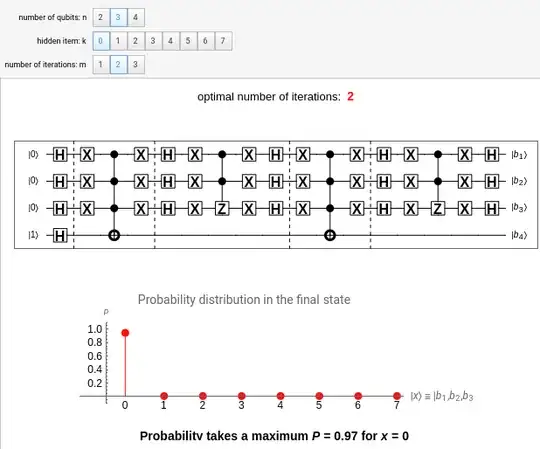

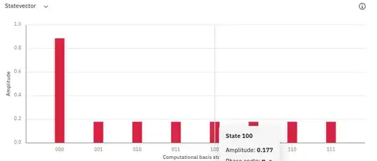

3-qubit single application of $|000\rangle$ inversion and amplification:
For multi-iterations, the $|000\rangle$ coefficient sign must be inverted again first each time, before applying the amplification.
from Wolfram demo.

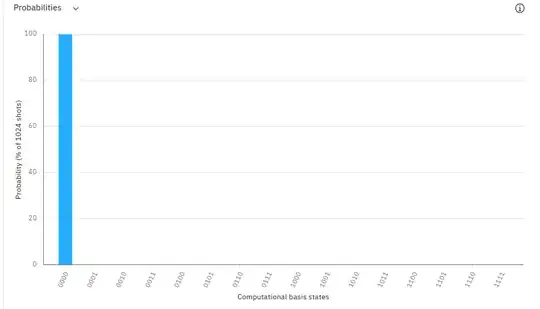

4-qubit single application of $|0000\rangle$ inversion and amplification:
