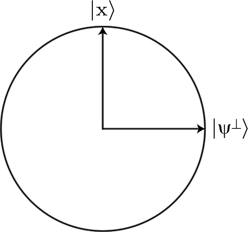

I find a graphical approach quite good for giving some insight without getting too technical. We need some inputs:
  • we can produce a state $|\psi\rangle$ with non-zero overlap with the 'marked' state $|x\rangle$: $\langle x|\psi\rangle\neq 0$.
  • we can implement an operation $U_1=-(\mathbb{I}-2|\psi\rangle\langle\psi|)$
  • we can implement an operation $U_2=\mathbb{I}-2|x\rangle\langle x|$.
This last operation is the one that can mark our marked item with a -1 phase. We can also define a state $|\psi^\perp\rangle$ to be orthonormal to $|x\rangle$ such that the $\{|x\rangle,|\psi^\perp\rangle\}$ forms an orthonormal basis for the span of $\{|x\rangle,|\psi\rangle\}$. Both the operations that we have defined preserve this space: you start with some state in the span of $\{|x\rangle,|\psi^\perp\rangle\}$, and they return a state within the span. Moreover, both are unitary, so the length of the input vector is preserved.
A vector of fixed length within a two-dimensional space can be visualised as the circumference of a circle. So, let's set up a circle with two orthogonal directions corresponding to $|\psi^\perp\rangle$ and $|x\rangle$. enter image description here

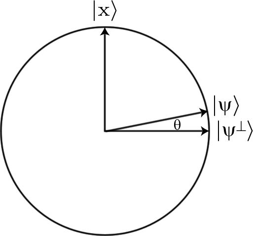

Our initial state $|\psi\rangle$ will have small overlap with $|x\rangle$ and large overlap with $|\psi^\perp\rangle$. If it were the other way around, search would be easy: we'd just prepare $|\psi\rangle$, measure, and test the output using the marking unitary, repeating until we got the marked item. It wouldn't take long. Let's call the angle between $|\psi\rangle$ and $|\psi^\perp\rangle$ the angle $\theta$. enter image description here

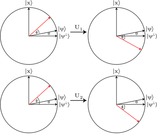

Now let's take a moment to think about what our two unitary actions do. Both have a -1 eigenvalue, and all other eigenvalues +1. In our two-dimensional subspace, that reduces to a +1 eigenvalue and a -1 eigenvalue. Such an operation is a reflection in the axis defined by the +1 eigenvector. So, $U_1$ is a reflection in the $|\psi\rangle$ axis, while $U_2$ is a reflection in the $|\psi^\perp\rangle$ axis. enter image description here

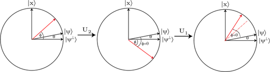

Now, take an arbitrary vector in this space, and apply $U_2$ followed by $U_1$. The net effect is that the vector is rotated by an angle $2\theta$ towards the $|x\rangle$ axis. enter image description here
So, if you start from $|\psi\rangle$, you can repeat this sufficiently many times, and get to within an angle $\theta$ of $|x\rangle$. Thus, when we measure that state, we get the value $x$ with high probability.
Now we need a little care to find the speed-up. Assume that the probability of finding $|x\rangle$ in $|\psi\rangle$ is $p\ll 1$. So, classically, we'd need $O(1/p)$ attempts to find it. In our quantum scenario, we have that $\sqrt{p}=\sin\theta\approx\theta$ (since $\theta$ is small), and we want a number of runs $r$ such that $\sin((2r+1)\theta)\approx 1$. So, $r\approx \frac{\pi}{2\theta}\approx \frac{\pi}{2\sqrt{p}}$. You can see the square-root speed-up right there.
