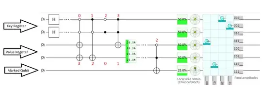

I've been working on this problem as well. As a beginner and a classical programmer (i.e., I don't speak Quantum Mechanics), it is difficult to get an understanding of the concepts without complete examples. I've been working with the Microsoft Q# Database Search sample. It simply searches for a specific index/key in the database, which is not very useful. I have expanded upon that sample to search a list of values in a database and return the corresponding key.
As with your example, there is one two-qubit "key register" for the indexes, and a separate two-qubit register for the values. There is also a fifth "marked qubit" that comes from Microsoft's sample, to indicate when the desired value is found. The keys and values are associated via entanglement. That is best demonstrated with a circuit. Click here to see the actual Quirk circuit.
Key/Value Oracle Circuit
Note that this circuit contains only the oracle. It does not implement all of Grover's algorithm.
  • The top two qubits are the key register, the next two are the value register, and the bottom qubit is the marked qubit.
  • The first section puts the key register in a uniform superposition using Haramard gates, as required by Grover's algorithm.
  • The second section is where the keys are associated with the values via entanglement. Each key is entangled with a corresponding value in the value register by applying (Anti-)Controlled X gates. So, when the key register is 0, then the value register will be set to 3. When the key is 1, the value is set to 2, and so on on.
  • The third section of the circuit is the search oracle. The value register is entangled with the marked qubit. In this example, the desired value is 2. When the value register contains 2, the marked qubit will be set to 1.
  • Grover's algorithm looks at the key register and marked qubit. The search oracle looks at the value register and sets the marked qubit. This will cause key 1 to be amplified when the value is 2.
It's interesting to note that the keys and values are not stored in the qubits, but rather in the circuit/program. You could say it's not really a database per se. It's more like a switch/case statement, but one that can run on a superposition of values.
For more details, caveats, and Q# code, see my GitHub repository.

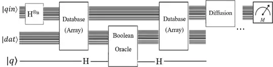

You need to convert the oracle to hold the database too, as a result, the general Oracle (Phase Inversion) will have two sub-oracles take a look the figure. General Grover's algorithm circuit for database searching

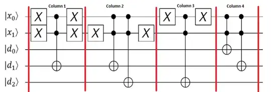

The first sub-oracle that have to prepared is the memory circuit, in contrast to QRAM which stores quantum data (state) in its body, this memory (array) circuit is prepared to store only classical information in its frame. An example of such kind of circuit that stores an array of binaries [010, 110, 100, 011] is displayed below: example for a memory circuit For more read this paper.

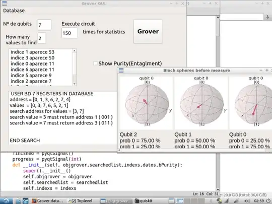

I have a sample with qiskit sample link
