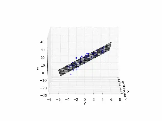

A simple least squares solution should do the trick.
The equation for a plane is: $ax + by + c = z$. So set up matrices like this with all your data:
$$ \begin{bmatrix} x_0 & y_0 & 1 \\ x_1 & y_1 & 1 \\ &... \\ x_n & y_n & 1 \\ \end{bmatrix} \begin{bmatrix} a \\ b \\ c \end{bmatrix} = \begin{bmatrix} z_0 \\ z_1 \\ ... \\ z_n \end{bmatrix} $$ In other words:
$$Ax = B$$
Now solve for $x$ which are your coefficients. But since (I assume) you have more than 3 points, the system is over-determined so you need to use the left pseudo inverse: $A^+ = (A^T A)^{-1} A^T$. So the answer is: $$ \begin{bmatrix} a \\ b \\ c \end{bmatrix} = (A^T A)^{-1} A^T B $$
And here is some simple Python code with an example:
import numpy as np
These constants are to create random data for the sake of this example
N_POINTS = 10 TARGET_X_SLOPE = 2 TARGET_y_SLOPE = 3 TARGET_OFFSET = 5 EXTENTS = 5 NOISE = 5
Create random data.
In your solution, you would provide your own xs, ys, and zs data.
xs = [np.random.uniform(2*EXTENTS)-EXTENTS for i in range(N_POINTS)] ys = [np.random.uniform(2*EXTENTS)-EXTENTS for i in range(N_POINTS)] zs = [] for i in range(N_POINTS): zs.append(xs[i]TARGET_X_SLOPE +
ys[i]
TARGET_y_SLOPE +
TARGET_OFFSET + np.random.normal(scale=NOISE))
plot raw data
plt.figure() ax = plt.subplot(111, projection='3d') ax.scatter(xs, ys, zs, color='b')
do fit
tmp_A = [] tmp_b = [] for i in range(len(xs)): tmp_A.append([xs[i], ys[i], 1]) tmp_b.append(zs[i]) b = np.matrix(tmp_b).T A = np.matrix(tmp_A)
Manual solution
fit = (A.T * A).I * A.T * b errors = b - A * fit residual = np.linalg.norm(errors)
Or use Scipy
from scipy.linalg import lstsq
fit, residual, rnk, s = lstsq(A, b)
print("solution: %f x + %f y + %f = z" % (fit[0], fit[1], fit[2])) print("errors: \n", errors) print("residual:", residual)
plot plane
xlim = ax.get_xlim() ylim = ax.get_ylim() X,Y = np.meshgrid(np.arange(xlim[0], xlim[1]), np.arange(ylim[0], ylim[1])) Z = np.zeros(X.shape) for r in range(X.shape[0]): for c in range(X.shape[1]): Z[r,c] = fit[0] * X[r,c] + fit[1] * Y[r,c] + fit[2] ax.plot_wireframe(X,Y,Z, color='k')
ax.set_xlabel('x') ax.set_ylabel('y') ax.set_zlabel('z') plt.show()
3D points and fit plane
Ben
  • 699
  • 19
    Am I correct to interpret that this method will solve for the plane that minimizes the vertical (ie: z) distance and not the perpendicular distance? – Gabriel Nov 08 '17 at 23:03
    Yes, it minimizes vertical distance. – Ben Nov 09 '17 at 00:00
  • Thank you very much for clarifying this Ben (and for the answer) If you have the time, I have a very similar question here (using Singular-Value Decomposition) that is giving me trouble. – Gabriel Nov 09 '17 at 18:36

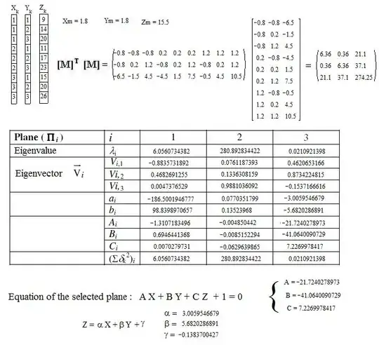

Considering a plane of equation $Ax+By+Cz=0$ and a point of coordinates $(x_i,y_i,z_i)$, the distance is given by $$d_i=\pm\frac{Ax_i+By_i+Cz_i}{\sqrt{A^2+B^2+C^2}}$$ and I suppose that you want to minimize $$F=\sum_{i=1}^n d_i^2=\sum_{i=1}^n\frac{(Ax_i+By_i+Cz_i)^2}{{A^2+B^2+C^2}}$$ Setting $C=1$, we then need to minimize with respect to $A,B$ $$F=\sum_{i=1}^n\frac{(Ax_i+By_i+z_i)^2}{{A^2+B^2+1}}$$
Taking derivatives with respect to A and B:
$$F'_A=\sum _{i=1}^n \left(\frac{2 x_i (A x_i+B y_i+z_i)}{A^2+B^2+1}-\frac{2 A (A x_i+B y_i+z_i)^2}{\left(A^2+B^2+1\right)^2}\right)$$ $$F'_B=\sum _{i=1}^n \left(\frac{2 y_i (A x_i+B y_i+z_i)}{A^2+B^2+1}-\frac{2 B (A x_i+B y_i+z_i)^2}{\left(A^2+B^2+1\right)^2}\right)$$ Since we shall set these derivatives equal to $0$, the equations can be simplified to $$\sum _{i=1}^n \left({ x_i (A x_i+B y_i+z_i)}-\frac{ A (A x_i+B y_i+z_i)^2}{\left(A^2+B^2+1\right)}\right)=0$$ $$\sum _{i=1}^n \left({ y_i (A x_i+B y_i+z_i)}-\frac{ B (A x_i+B y_i+z_i)^2}{\left(A^2+B^2+1\right)}\right)=0$$ whic are nonlinear with respect to the parameters $A,B$; then, good estimates are required since you will probably use Newton-Raphson for polishing the solutions.
These can be obtained making first a multilinear regression (with no intercept in your cas) $$z=\alpha x+\beta y$$ and use $A=-\alpha$ and $B=-\beta$ for starting the iterative process. The values are given by $$A=-\frac{\text{Sxy} \,\text{Syz}-\text{Sxz}\, \text{Syy}}{\text{Sxy}^2-\text{Sxx}\, \text{Syy}}\qquad B=-\frac{\text{Sxy}\, \text{Sxz}-\text{Sxx}\, \text{Syz}}{\text{Sxy}^2-\text{Sxx}\, \text{Syy}}$$
For illustration purposes, let me consider the following data $$\left( \begin{array}{ccc} x & y & z \\ 1 & 1 & 9 \\ 1 & 2 & 14 \\ 1 & 3 & 20 \\ 2 & 1 & 11 \\ 2 & 2 & 17 \\ 2 & 3 & 23 \\ 3 & 1 & 15 \\ 3 & 2 & 20 \\ 3 & 3 & 26 \end{array} \right)$$
The preliminary step gives $z=2.97436 x+5.64103 y$ and solving the rigorous equations converges to $A=-2.97075$, $B=-5.64702$ which are quite close to the estimates (because of small errors).
    In your example, the equation of the plane $z=Ax+By$ is carried out with respect to the criteria of the least square orthogonal distances between the points and the plane. I agree with your result. But, they are only two adjustable parameters $A,B$ because the origin $(0,0,0)$ is supposed to be on the plan. This is an additional condition. If we consider the more general equation of the plan $z=Ax+By+C$ the three parameters problem should lead to a better fitting with lower mean square deviation. – JJacquelin Feb 12 '16 at 15:18
    The general plane equation is $Ax+By+Cz+D=0$ or $Ax+By+Cz=1$ – John Alexiou Nov 12 '22 at 00:19
In order to complete the Claude Leibovici's answer :
With the numerical example proposed by Claude Leibovici who computed the parameters of a fitted plane $\quad z=Ax+By\quad$, the fitting of the plane $\quad Z=\alpha X+\beta Y+\gamma\quad$ can be carried out thanks to the principal components method (as suggested by joriki).
The theory can be found in many books. A synopsis is given pages 24-25 in the paper: https://fr.scribd.com/doc/31477970/Regressions-et-trajectoires-3D
The symbols used below correspond to those in the formulas from the referenced paper.

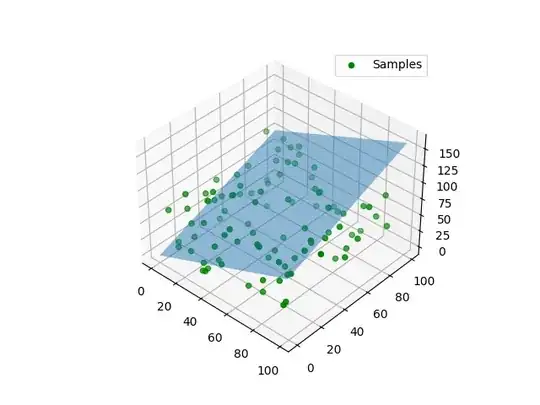

All the other answers are amazing. I am providing an another way of doing this. You can use RANSAC. This method may not be more efficient than the other methods.
Simple theory behind this method is to pick random samples from the input sample, and create mathematical model that better describes your problem. After that find the error of this mathematical model with respect to all the samples, and count the number of samples whose error is within a given threshold (These samples are called inliers) . Do this procedure for multiple iterations and return the model that has more number of inliers.
For your specific problem, at a give iteration , you can pick three random points, and construct a plane using those points. The generalized equation of a plane is as given by $Ax+By+Cz+D=0$. Now for every point of coordinates $(x_i,y_i,z_i)$ in the input sample , find the distance between point and the plane. This can be your error definition. The distance between the plane and the point is given by $$d_i=\pm\frac{Ax_i+By_i+Cz_i+D}{\sqrt{A^2+B^2+C^2}}$$ These equations are taken from Claude's answer.
If this value is less than a given threshold, you can count that point as an inlier. Repeat this process for certain number of iterations. The following python program implements this method.
import numpy as np
def EoP(p1,p2,p3): """for a given three points, finds out the equation of plane""" v1 = p3 - p1 v2 = p2 - p1 cp = np.cross(v1, v2) A,B,C = cp D = np.dot(cp, p3) return A,B,C,D
def RANSAC(X,itr=5000,threshold=500): """ Inputs: X- sample coordinates
itr - number of iterations
threshold - error threshold
output:
Three  coordinates of a plane if RANSAC found the best fit
N = X.shape[0] #size of the smaple
n=0
for i in range(itr):
    idx = np.random.randint(N,size=(1,3))[0]  #generating three random indices
    Xsample = X[idx]  #gather the coordinates with those indices
    p1,p2,p3 = Xsample# unpacking three points
    A,B,C,D = EoP(p1,p2,p3)  #Equation of plane
    # print(A,B,C,D)
    inliers= 0
    #Now for every point in input sample, find if it is a inlier
    for p in X:
        xi,yi,zi = p
        d = np.abs((A*xi+B*yi+C*zi+D)/np.sqrt(xi**2+yi**2+zi**2))
        if d<threshold:
            inliers+=1 # finding out the inliers that satisfy the distance condition
    if inliers > n:
        Abest = A
        Bbest = B
        Cbest = C
        Dbest = D
if inliers > 0:
    return (Abest , Bbest, Cbest, Dbest)
return None
if name == "main": rdm = np.random.RandomState(10) # to repeat the random state X = rdm.randint(100,size=(100,3)) fig = plt.figure() ax = plt.axes(projection='3d') Out = RANSAC(X) if Out: A,B,C,D = Out ax.scatter3D(X[:,0],X[:,1],X[:,2],c="g",label="Samples") xx, yy = np.meshgrid(range(100), range(100)) z = -(Axx+Byy+D)/C ax.plot_surface(xx, yy, z, alpha=0.5) #,label = "Best Fit Plane ") plt.legend() plt.show()
else:
    print("No best RANSAC")
This program results the following for a random input :
The problems with this method :
  1. May need tuning for iterations and threshold
  2. Since the random points are taken to form the mathematical model , this may not give you the best ouput
  3. This is slow !
