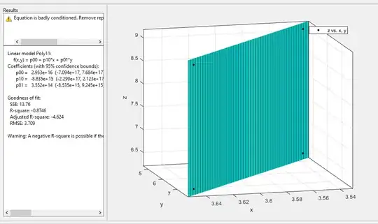

I am trying to fit a plane of the form $ax+by+c=z$ to these 4 coordinates. I tried both the analytical least-squares solution, as described here, and an iterative approach described here. These both result in relatively high root-mean-square-errors but I am not sure why. Using the curve fitting toolbox in MATLAB results in an $r^2$ that's negative and notes that the equation is badly conditioned, although visually the resulting fit looks okay somehow (image below).
It is rather intuitive what the plane should be. What can I do to get a more accurate solution? Mathematically, what is the issue with this set of coordinates?

    In general, four points in $\mathbb{R}^3$ don't have to be coplanar.
    However, in your case, there does in fact exist a plane that contains all four points (additionally, your four points are the vertices of a rectangle that is not a square, but this is not directly relevant).
    – Zubin Mukerjee Dec 23 '17 at 04:55
  • Of course, that makes sense. I'm mainly confused because in this case, as you correctly mentioned, the four points are the vertices of a rectangle, so there should be not only a good planar fit but a perfect fit. – Argon Dec 23 '17 at 04:58

The problem is that the four points lie on a plane that is vertical. i.e. you can write it as
$$2.78730x-0.11207y-9.3149292113 = 0.$$
So you won't be able to fit a plane of the form $$ax+by+c=z$$ to these points.
