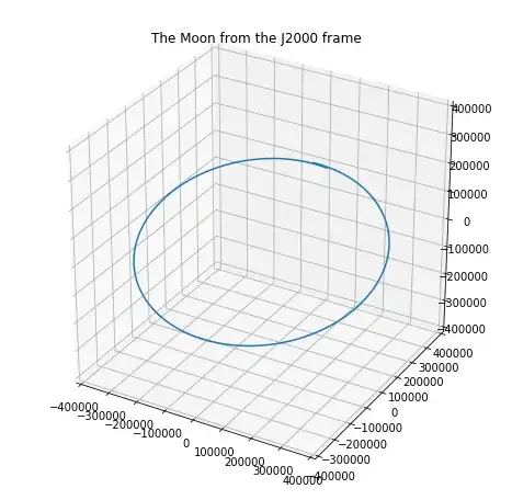

I've used NASA's highly precise SPICE toolkit to calculate the hourly position of the moon relative to the Earth in Cartesian coordinates. The frame of reference for these points is the J2000 frame: Earth's equator (x and y), with the z-axis running orthogonally through the poles.
We know the moon's orbit does not lie on the equatorial plane. The Earth-Moon orbit is typically described as a plane that is 5.14 degrees inclined from the equatorial plane.
(This is a 28-day period from Jan. 2018, hence the small overlap since the sidereal month is 27.32 days.)
What I want to determine is whether this orbit is perfectly "flat" -- whether the Moon orbits the Earth on a perfect plane rotated from the terrestrial equator -- or whether there is even a slight variance on the z axis of this approximate Earth-Moon orbital plane.

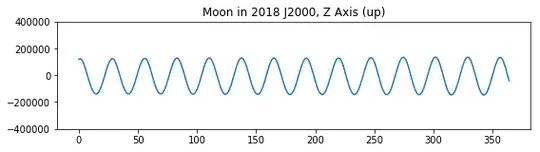

It's certainly very close to a plane, as we'd expect, as you can see from a year's worth of z coordinates from the Earth's frame of reference. But orbit's are hugely complicated given all the possible aberrations, which the SPICE toolkit usually accounts for.

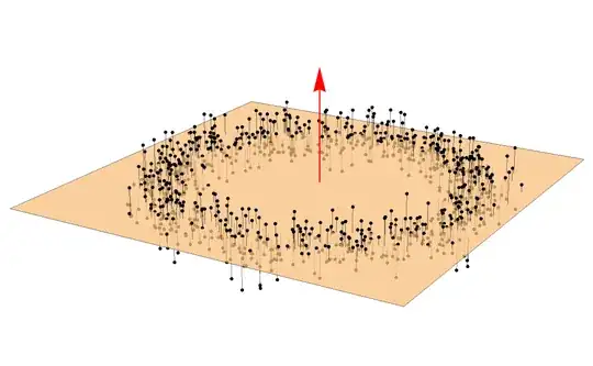

Edit 4: here is a picture of some points, the plane, the unit normal, and the segments indicating the distances of the points to the plane:
