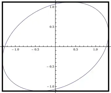

Here is a Mathematica demonstration:
With[{a = Sqrt[2], b = 1, th = Pi/6},
 Block[{xa = Sqrt[a^2 Cos[th]^2 + b^2 Sin[th]^2],
        ya = Sqrt[a^2 Sin[th]^2 + b^2 Cos[th]^2]},
       ParametricPlot[
         RotationMatrix[th].{a Cos[u], b Sin[u]}, {u, 0, 2 Pi},
         Epilog -> {AbsoluteThickness[4],
         Line[{{-xa, -ya}, {xa, -ya}, {xa, ya}, {-xa, ya}, {-xa, -ya}}]}
ellipse in rectangle
