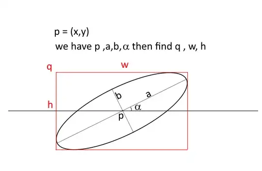

Suppose have arbitrary ellipse with center $(x,y)$ and its radius $(a,b)$. I want obtain rectangle that sides tangent of peripheral ellipse. the below image describe issue :

please give me more explanation to find my unknown values specified in image. – ali kiani Jan 19 '19 at 14:59
i found this solution works fine. – ali kiani Jan 21 '19 at 05:27
