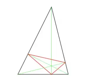

Does every triangular billiard have a periodic orbit?
For acute triangles, the question has been answered affirmatively by Fagnano in 1775: one can simply take the length $3$ orbit joining the basepoints of the heights of the triangle.
For (generic) obtuse triangles, the answer is not known in spite of very considerable efforts of many mathematicians. Apparently, A. Katok has offered a $10.000$\$ prize for a solution of this problem.

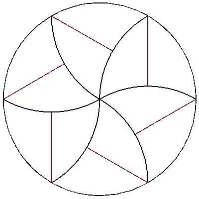

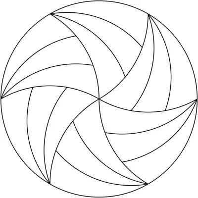

Can a disk be tiled by a finite number of congruent pieces (You can rotate or flip pieces onto each other) such that the center of the disk is contained in the interior of one of the pieces?
So far, the only kinds of tilings of the disk by congruent pieces, which we know of, all have the center of the disk lying on the boundary of more than one piece. Here are some examples which fail to have the center in the interior of one of the pieces:
enter image description here From Robert Israel's answer
enter image description here From robjohn's answer
