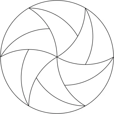

Here is another with 12 pieces, but all pieces have the same orientation:
$\hspace{32mm}$enter image description here

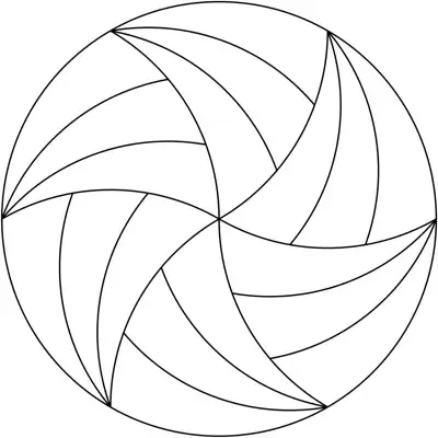

Using this idea, the pizza can be divided into $6n$ equal pieces with the same orientation for any $n$. However, to have some pieces with no crust, we need $n\gt1$. Above is $n=2$, here is $n=3$:

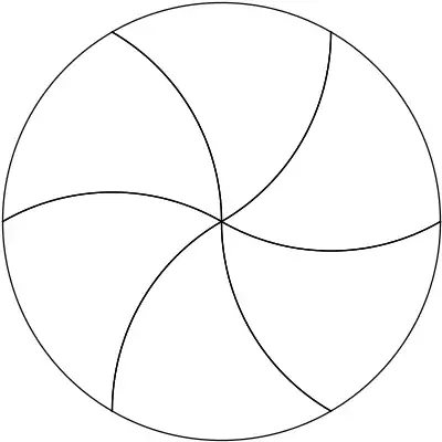

Connecting each vertex to the center with arcs centered at the previous vertex, we get the circle tiled by $6$ curvy triangles with congruent sides; two convex sides and one concave side. The centers of the convex sides are the opposite vertices of the curvy triangle. Since the chords of the curved sides have a length $1$ radius, we can trace out the interior convex sides with a congruent arc rotating about the opposite vertex.
Since we can sweep out these $6$ triangles with these congruent arcs, we can split up the curvy triangles into any number of congruent pieces with these arcs.

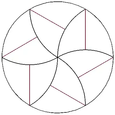

Here is one solution in $12$ pieces.

  • This is the solution I had in mind as well. There are also (a family of) solutions where all pieces have the same orientation. – Dan Rust Sep 01 '13 at 19:02
  • +1: I was working on a drawing of this. Back to the drawing board :-) – robjohn Sep 01 '13 at 19:03

    Six of the pieces here only have crust on one corner, but didn't the problem say absolutely none? – Hakanai Sep 02 '13 at 05:29
    @Trejkaz: The requirement is only that the measure of crust included in some piece $A_i$, i.e. $\lambda(A_i \cap \partial D)$, be 0. A single point of idealized zero-thickness crust is OK since that has measure 0. – The_Sympathizer Sep 02 '13 at 05:43
