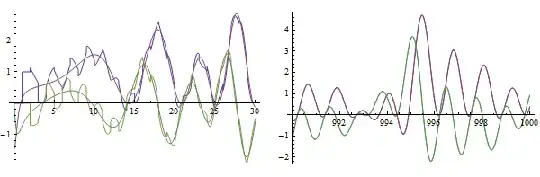

? Below is a plot of $$\sum_{n=1}^{y}\dfrac{1}{n^{s}}\text{for }s=\dfrac{1}{2}+iy$$
set against its smooth analytic continuation. Is this less expensive computationally for large $y$?
Notes
x = 1/2; Plot[{Re[\!\( \*SubsuperscriptBox[\(\[Sum]\), \(n = 1\), \(y\)]
\*FractionBox[\(1\), SuperscriptBox[\(n\), \(x + I\ y\)]]\)],
Re[Zeta[x + I y]], Im[\!\( \*SubsuperscriptBox[\(\[Sum]\), \(n = 1\), \(y\)]
Im[Zeta[x + I y]]}, {y, 0, 30}]
Included with subsuperscript boxes for ease of reading when pasted into Mathematica.

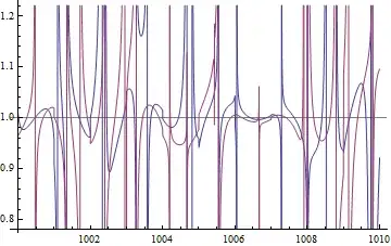

To address Mercio's point:
The plot of the quotients (as posed in the original question) is very messy (includes grid-line at $1$), and clearly doesn't "tend to $1$" in the strict sense of the meaning. Perhaps if zeros of each function were excepted, it would make more sense. Suggestions of re-phrasings of the question are welcomed!

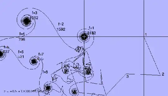

As a complement to John M's proof (+1) I'll add some 'visual clarifications' (whatever this may mean...) about the behavior of the finite sum of $\zeta\;$ for a large but fixed ordinate $y\in\mathbb{R}^+$ : $$\tag{1}S_y(N)=\sum_{k=1}^N\frac 1{k^{\,1/2+iy}}$$ Let's suppose that $y$ is the first ordinate of a nontrivial zero larger than $10000$ and represent all the partial sums $\,S_y(N)$ for $\;N=1\cdots 3183=[y/\pi]\;$ in the complex plane :
N=3183
The cross at the middle is at the origin ($z=0$) while '1' represents $z=S_y(1)=1$ and '2' $\;S_y(2)=1+\dfrac {2^{-iy}}{\sqrt{2}}$ and so on up to '3183' representing $\;S_y(3183)$ very near to $0$ again. $$-$$ The picture shows figures looking like Cornu (or Euler) spirals. Let's justify this :
the sum $S_y(N)$ is obtained by addition of terms $\,\displaystyle \frac 1{k^{1/2+iy}}=\frac {e^{-iy\log(k)}}{\sqrt{k}}$.
The next term will thus be $\,\displaystyle \frac {e^{-iy\log(k+1)}}{\sqrt{k+1}}$.
Now for $k\gg 1$ the denominator will change only slightly while the change of phase of the numerator will be $\;\delta=-y\;(\log(k+1)-\log(k))=-y\,\log(1+1/k)\approx -\dfrac yk$.
$\delta\approx -\dfrac {y}k$ gives a special role to the values of $k$ such that $\dfrac yk\approx f\pi$ with $f$ integer :
  • for $f=2m$ (i.e. $k=\left[ \frac y{2m\pi}\right]$) we have $\,\delta\approx -2m\pi\,$ : for values of $k$ near of $\left[ \frac y{2m\pi}\right]$ the terms have nearly the same phase and their addition will nearly give a straight line (see f=2, f=4, and so on on the picture)
  • for $f=2m+1$ (i.e. $k=\left[ \frac y{(2m+1)\pi}\right]$) we have $\,\delta\approx -(2m+1)\pi\,$ : for values of $k$ near of $\left[ \frac y{(2m+1)\pi}\right]$ two consecutive terms nearly cancel each other and that's what is happening in the middle of the 'nodes' f=1, f=3, f=5 and so on.

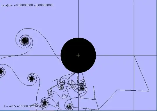

Let's zoom the center of the final node $f=1$ :
zoom
The line nearly crossing the origin is obtained with the term $k=3183=\left[ y/\pi\right]$ while the line at its left and right came from $k=3182$ and $k=3181$ respectively. The value $S_y(3183)$ itself is far out of the picture (say $12$ or more times higher) while $S_y(3182)$ is far at the bottom on the other side. Taking the middle of these two values should bring us not too far from our target even if the different partial sums $S_y(N)$ don't really 'go down to $0$' ! (they merely turn around it)
All this explains (but doesn't prove) that an excellent approximation for $\zeta$ may be obtained (near the zeros at least) with the formula : $$\zeta\left(\frac 12+iy\right)\approx -\frac 1{2\,[y/\pi]^{1/2+iy}}+\sum_{n=1}^{[y/ \pi]}\frac{1}{n^{1/2+iy}}$$
(numerically the absolute error appears majored by $\dfrac{2.5}{y^{3/2}}$ in the range $(10,10000)$, and probably for larger values, while the initial sum from the question was majored by $\dfrac{0.9}{y^{1/2}}$)

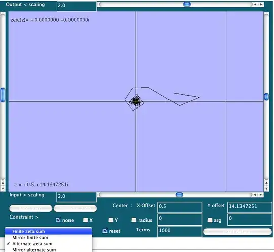

  • Select 'Finite zeta sum' in the (possibily hidden) combobox at the bottom left. Set Y offset=10000 (return) and click on 'Next zero'. After that change the number of terms at the bottom and zoom with the scrollbar at the top (click on the arrows rather than using the thumb.) – Raymond Manzoni Jun 01 '14 at 20:22
  • I tried y = 10000; ListLinePlot[ Table[{Im[E^(-I y Log[k])/Sqrt[k]], Re[E^(-I y Log[k])/Sqrt[k]]}, {k, 1, 3183}]] (in Mathematica) which gives a very muddled plot compared to your one above... – martin Jun 01 '14 at 20:35
  • ... I will go with the diplomatic approach as advised, but, to be honest I think I have learned a great deal more in the short term from your answer (in particular , due to the support you provided in the mean time), but I can't help thinking that the art of answering a question is gauging the level of the asker, and tailoring the answer accordingly. Perhaps when I eventually become a little more competent, I shall more fully appreciate the value of John M's answer... – martin Jun 01 '14 at 20:36
  • ...I do not understand what you mean by 'combobox' btw - nor can I find any ref to CSE, even though I have read the link you provided - please excuse my ignorance on these matters! :/ – martin Jun 01 '14 at 20:36
  • @martin: Well the Critical Strip Explorer is the applet at the bottom of the page and if you click at the lower left part you should see this list deployed (it is an applet from around 2001 so that modern browser support may be poor sorry...). There are no other reference than on this page (or the java source code) but I'll answer questions you could have about it. – Raymond Manzoni Jun 01 '14 at 20:48
  • (of course java has to be activated if you want the applet to work!) – Raymond Manzoni Jun 01 '14 at 20:53
