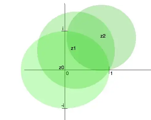

Let's start on the real axis near $x_0$ with the more general expansion : $$f(x)=a_0+a_1(x-x_0)+a_2(x-x_0)^2+\cdots$$ To simplify a little analytic continuation is about getting the same expansion $$f(z)=a_0+a_1(z-z_0)+a_2(z-z_0)^2+\cdots$$ for complex numbers $z$ around a complex point $z_0$ and similar expansions $f(z)=b_0+b_1(z-z_1)+b_2(z-z_1)^2+\cdots\;$ around other points $z_1,\;z_2$ and so to cover as much as possible the complex plane.
Let's start for example with $z_0=x_0=0$ for the $\displaystyle\frac 1{1-z}$ function (with a unit radius convergence disk) followed by two other disks centered at the complex values $z_1$, $z_2$ (avoiding the pole at $z=1$) then we get this picture :

One advantage of complex analysis is that you'll see directly that for example $\displaystyle\frac 1{1+z^2}$ has a problem at $z=i$ and $z=-i$ (because the denominator vanishes !). Since $|i-0|=|-i-0|=1$ you may deduce that the convergence radius at $z_0=0$ of $\displaystyle\frac 1{1+z^2}=1-z^2+z^4-\cdots\,$ is $1$ (since the unit circle centered at $0$ will 'touch' the imaginary $i$ as well as $-i$ as illustrated above).
