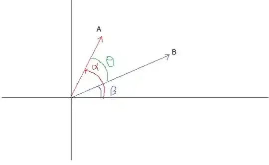

Consider the following, doing the $2$-D case, which can be generalized to $n$-D.
Vector $A$ with coordinates $(x_A,y_A)$
Vector $B$ with coordinates $(x_B,y_B)$
Vectors A and B
The dot product of those two vectors is : \begin{align*} A\cdot B &= AB\cos(\theta) \\ &= AB\cos(\alpha−\beta)\qquad(\mathrm{since}\,\theta=\alpha-\beta) \\ &= AB(\cos(\alpha)\cos(\beta) + \sin(\alpha)\sin(\beta)) \\ &= AB\cos(\alpha)\cos(\beta) + AB\sin(\alpha)\sin(\beta) \\ &= A\cos(\alpha)B\cos(\beta) + A\sin(\alpha)B\sin(\beta) \\ &= x_Ax_B + y_Ay_B \end{align*}
