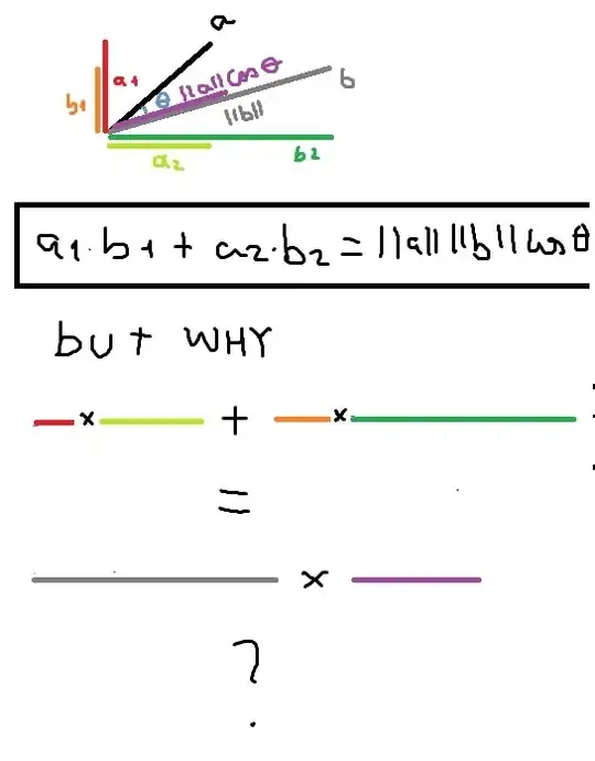

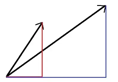

I'm searching to develop the intuition (rather than memorization) in relating the two forms of a dot product (by an angle theta between the vectors and by the components of the vector ).
For example, suppose I have vector $\mathbf{a} = (a_1,a_2)$ and vector $\mathbf{b}=(b_1,b_2)$. What's the physical or geometrical meaning that
$$a_1b_1 + a_2b_2 = |\mathbf{a}||\mathbf{b}|\cos(\theta)\;?$$

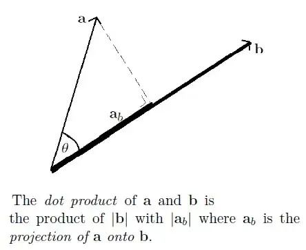

Why is multiplying $|\mathbf{b}|$ times $|\mathbf{a}|$ in direction of $\mathbf{b}$ the same as multiplying the first and second components of $\mathbf{a}$ and $\mathbf{b}$ and summing ?
I know this relationship comes out when we use the law of cosines to prove, but even then i cant get a intuition in this relationship.
This image clarifies my doubt:
Thanks

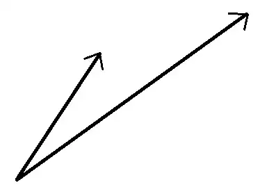

I don't know if this is exactly what you are looking for, but here is an alternative geometrical or physical explanation of the identity.
Consider the vector $\underline{b}'$ which is perpendicular to $\underline{b}$ and has components $(b_2,-b_1)$
Then the area of the parallelogram formed by the vectors $\underline{a}$ and $\underline{b}'$ is, by consideration of the surrounding rectangle comprising the components, equal to $$(a_1+b_2)(a_2+b_1)-a_1a_2-b_1b_2=a_1b_1+a_2b_2$$
But the area of the parallelogram is also $$|a||b|\sin(90-\theta)=|a||b|\cos\theta$$

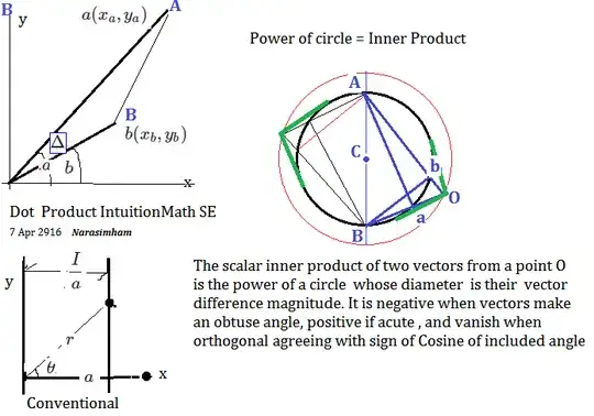

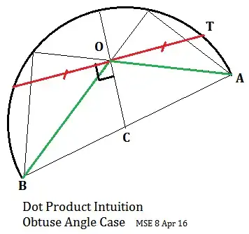

My Intuition for Vector DotProduct
Vector dot product can be seen as Power of a Circle with their Vector Difference absolute value as Circle diameter. The green segment shown is square-root of Power.
My Intution_Circle Power
Obtuse Angle Case
Here the dot product of obtuse angle separated vectors $( OA, OB ) = - OT^2 $
DotProdObtruse

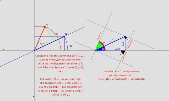

By the scalar product (synonymously, the dot product) of two vectors $\mathbf{A}$ and $\mathbf{B}$, denoted by $\mathbf{A} \cdot\mathbf{B}$, we mean the quantity: \begin{equation} \mathbf{A} \cdot\mathbf{B} = |\mathbf{A}| |\mathbf{B}| cos(\mathbf{A},\mathbf{B}) \end{equation} i.e., the product of the magnitudes of the vectors times the cosine of the angle between them. It follows from the above relationship that the scalar product of $\mathbf{A}$ and $\mathbf{B}$ equals the magnitude of $\mathbf{A}$ times the projection of $\mathbf{B}$ onto the direction of $\mathbf{A}$. As a matter of fact, the projection of $\mathbf{A}$ onto $\mathbf{A}$, denoted by $\mathbf{A_B}$ is length of the segment cut from $\mathbf{B}$ by the planes drawn through the end points of $\mathbf{A}$ perpendicular to $\mathbf{B}$, taken with the plus sign if the direction from the projection (onto $\mathbf{B}$) of the initial point of $\mathbf{A}$ to the projection of the end point of $\mathbf{B}$ coincides with the positive direction of $\mathbf{B}$, and with the minus sign otherwise. We can also conclude that: \begin{equation} \mathbf{A} \cdot\mathbf{B} = \mathbf{A_B} \cdot \mathbf{B} =\mathbf{A} \cdot \mathbf{B_A} \end{equation} Thus Scalar multiplication of two vectors is commutative. Given a system of rectangular coordinates ${x^1,x^2,x^3}$ let $\mathbf{i_1,i_2,i_3}$ the corresponding basis vectors. Then any vector \mathbf{A} can be represented in the form: \begin{equation} \mathbf{A} = A_1 \mathbf{i_1}+A_2 \mathbf{i_2}+A_3 \mathbf{i_3} \end{equation} Since the vectors $\mathbf{i_1,i_2,i_3}$ are orthonormal we have \begin{equation} \mathbf{i_j} \cdot \mathbf{i_k}=\delta_{j,k} \end{equation} Then \begin{equation} \mathbf{A} \cdot \mathbf{i_1} = (A_1 \mathbf{i_1}+A_2 \mathbf{i_2}+A_3 \mathbf{i_3}) \cdot \mathbf{i_1} = A_1 \end{equation} In the similar way we have $\mathbf{A} \cdot \mathbf{i_2}=A_2 $ and $\mathbf{A} \cdot \mathbf{i_3}=A_3 $. In other words, $A_1$, $A_2$ and $A_3$ are the projections of the vector $\mathbf{A}$ onto the coordinate axes. Wae can also write: \begin{equation} \mathbf{A} = (\mathbf{A} \cdot \mathbf{i_1}) \cdot \mathbf{i_1} +(\mathbf{A} \cdot \mathbf{i_2}) \cdot \mathbf{i_2} + (\mathbf{A} \cdot \mathbf{i_3}) \cdot \mathbf{i_3} \end{equation} The scalar product of two vectors A and B can easily be expressed in terms of their components: \begin{equation} \mathbf{A} \cdot \mathbf{B} = (A_1 \mathbf{i_1}+A_2 \mathbf{i_2}+A_3 \mathbf{i_3}) \cdot (B_1 \mathbf{i_1}+B_2 \mathbf{i_2}+B_3 \mathbf{i_3}) \end{equation} And when using the orthonormality condition: \begin{equation} \mathbf{A} \cdot \mathbf{B} = A_1 B_1 + A_2 B_2 +A_3 B_3 \end{equation}
cos(α−β) = cos(α)cos(β) + sin(α)sin(β)
I hope the picture shows the basic intuition underlying the definition itself of dot products.
I wished to develop the picture by Processing, by processing.org, which I consider a very interesting tool, although not so apt to develop a picture like this one.
