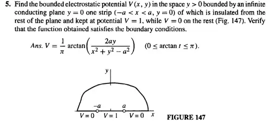

The idea is through conformal transformations satisfying the conditions requested of the problem make this an easier problem to deal,but i don't know which be this transformation. I would appreciate any hint how to solve this. thank you very much
Jhon Jairo
  • 1,051
Looking at my copy of Churchill, Complex Variables with Applications, the appendix on conformal transformations suggests that applying
$$ w = f(z) = \log \left(\frac{z-1}{z+1} \right) $$
will transform the region shown (for the case $a = 1$) into a strip in the $w$-plane, where the $V = 1$ rays are mapped to $\Im(w) = \pi$ and the $V = 0$ segment is mapped to $\Im(w) = 0$.
If you take $g(z) = \frac{1}{\pi} f(z)$, you map this region to one in which the $V = 1$ segment maps to $\Im(w) = 1$, and the $V = 0$ segment maps to $\Im(w) = 0$.
I seem to recall that this is what's needed in this kind of problem, but it's as far as my shoddy memory takes me. (The inverse conformal map for $f$, by the way, is $z = -\coth \frac{w}{2}$.)
OK. I went and read the relevant chapter of Churchill ... and found this problem in the exercises!
I think that having come up with the transformation, and the potential in the $w$-plane, I'm going to leave the conversion back to a potential in the $z$-plane up to you, although I confess I don't see offhand how to get from the $\log$-expression back to something involving $\arctan$.

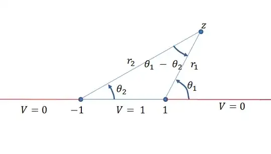

In comments, I've been asked to add some pics to show off what the log-transform is doing. Let's look at this diagram:The point $z$ in the upper half plane, relative to $-1$ and $+1$
Now the "log" that I've used above is really $$ w = \log |\frac{z-1}{z+1}| + i \arg \frac{z-1}{z+1}. $$
Let's look at how that gets computed. First, the first ratio is just the ratio of distances to the two point $+1$ and $-1$; I'll come back to that. The second term -- the imaginary part, is the difference of the args of $z-1$ and $z - (-1)$, i.e., the angle labeled $\theta_1 - \theta_2$ in the diagram.
What's that look like on (or very near) the real axis? Well, for $z > 1$, $\theta_1$ and $\theta_2$ will both be nearly zero; for $z < -1$, they'll both be nearly $\pi$. For $-1 < z < 1$, we have $\theta_2 \sim 0$ and $\theta_1 \sim \pi$, so the difference is approximately $\pi$. In other words, the red segments of the real axis will be sent to $v = 0$ in the $w$-plane, but the blue segment will be sent to $v = \pi$. Note that the remote ends of the red segments (near $\pm \infty$) will be sent to $u = 0$, while the near ends (near $\pm 1$) are sent off to infinity.
What about the ratio of lengths? Well, along the $x = 0$ line, we'll have $r_1 = r_2$, so that will map to $u = 0$. The other $u = constant$ lines will become hyperbolic-like curves in the $xy$-plane.
Finally, the transform we really want is $$ w = \frac{1}{\pi}\log |\frac{z-1}{z+1}| + \frac{i}{\pi} \arg \frac{z-1}{z+1}, $$ which sends the blue segment to the $v = 1$ line in the $w$-plane.
Now since the imaginary part of $w$ is $v$, and we can substitute $x+iy$ for $z$, we get \begin{align} v &= \frac{1}{\pi} \arg \frac{z-1}{z+1} \\ &= \frac{1}{\pi} \arg \frac{(x-1) + iy}{(x+1) + iy} \\ &= \frac{1}{\pi} \arg \frac{x^2 + y^2 - 1 + i 2y}{(x+1)^2 + y^2} \\ &= \frac{1}{\pi} \arg {x^2 + y^2 - 1 + i 2y}\\ &= \frac{1}{\pi} \arctan \frac{2y}{x^2 + y^2 - 1}, \end{align} which is an expression for the potential at point $(x, y)$.

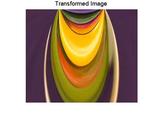

The transformed image, extending from -10 to 10 in $u$ and $0$ to $1$ in $v$, is this: enter image description here
If you can make sense of those, then bless you. I just followed the description given here: http://www.mathworks.com/help/images/examples/exploring-a-conformal-mapping.html to make the images. Here's my code:

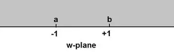

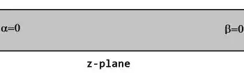

For completeness of the record, I've decided to formulate my previously given comment as an answer. Yes, the mapping in John's answer is a Schwarz-Christoffel mapping :
In general we have: $$\frac{dw}{dz}=K(z-a)^{\alpha/\pi-1}(z-b)^{\beta/\pi-1}$$ With $a=-1$ , $b=+1$ and $\alpha=\beta=0$ , giving: $$dw\;=\;K(z-1)^{-1}(z+1)^{-1}dz \;=\;\frac{K}{2}\left(\frac{dz}{z-1}-\frac{dz}{z+1}\right)$$ So indeed, integration gives apart from constants that can be determined (later): $$w=\log\left(\frac{z-1}{z+1}\right)$$
