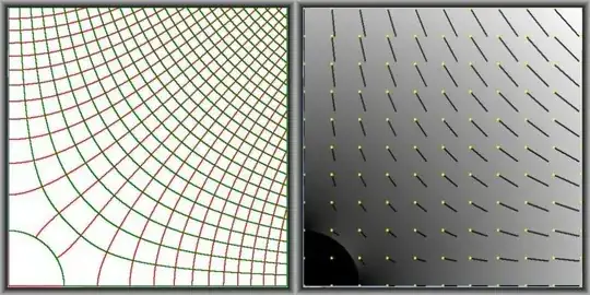

Anyway, here is a contour plot of the flow $\color{red}{potential}$ together with the $\color{green}{stream function}$ .
Contour lines are at $25$ levels between the minimum and the maximum, $A=1$ and the viewport is $(0 \le x \le 5 , 0 \le y \le 5)$ . Augmented with a vector plot with (scaled) velocities and grey values for the speed (lighter at greater speed, black=zero inside circle).
