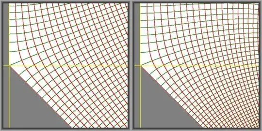

A contour plot of both $\,g(z)\,$ - on the left - and $\,T(g(z))\,$ - on the right - shows the differences.
The viewports are $\,-0.1 < x < 1.9$ , $-1 < y < +1\,$ with $\,z = x+i\,y$ ; isolines of the Imaginary parts are in $\color{red}{red}$ and isolines of the Real parts are in $\color{green}{green}$ . Contour levels are between $-4$ and $+4$ with steps of $4/30$.
