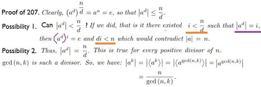

(3.) How do you envisage and envision the crafty first line in the proof? It feels supernormal to start with a magical exponent in $(a^d)^{n/d} = e$ that implies an inequality, $|a^d| \le n/d$.

$1$. You are trying to find the order of the element $a^d$. The only thing you know about $a$ is that it has order $n$; in particular, $a^n = 1$. So, if you can get some power of $a^d$ to simplify to $a^n$, this will be $1$. As $d$ is a divisor of $n$, the fraction $\frac{n}{d}$ is an integer so we can take $a^d$ to the $\left(\frac{n}{d}\right)^{\text{th}}$ power which gives $$(a^d)^{\frac{n}{d}} = a^{d\times\frac{n}{d}} = a^n = 1.$$ We know that $\frac{n}{d}$ is a positive ($d$ is positive, so $\frac{n}{d}$ is positive) integer such that $(a^d)^{\frac{n}{d}} = 1$. So the order of $a^d$, which is the smallest positive integer $k$ such that $(a^d)^k = 1$, is less than $\frac{n}{d}$ (i.e. $|a^d| \leq \frac{n}{d}$). We still have to show that $\frac{n}{d}$ is the smallest such positive integer.

Not sure what you are asking, but here is the intuition behind 207.
Look at the group generated by $a^d$. Let $k=n/d$. The elements are $$a^d, a^{2d}, a^{3d}, \cdots,a^{(k-1)d}, \quad a^{kd}=1$$ The last element is $1$ since $a^n=1$. Can any earlier item be $1$?
No, if it did then the order of the group generated by $a$ is less than $n$ (it will be no more than the power in the earlier one). Hence $\left|a^d \right| = n/d$
