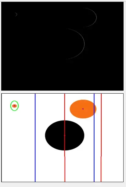

I'm implementing a system that uses a least squares algorithm to fit an ellipse to a set of data points. I've successfully managed to obtain approximate locations for the centre of the ellipse but I am having trouble with the major and minor axes. I'm writing this in C++ using OpenCV so I need to be able to express them as some kind of equation so I can calculate them. Right now I am just testing it with very basic circles rather than what I'll actually be using the program for.
Result of my program
Result of my program, where the top image is the data points (3 contours) and the bottom image is my approximated ellipses. The solid circles are the original image, purple dot is the centre of my approximated ellipse and the green, blue and red curves my approximated ellipses for the contours. The ellipses have not been rotated to the approximated angle yet (I will do this later).

For example. The black circle with the blue 'ellipse' around it. I have
$A = 3.876e-013$ $B = 1.8819e-012$ $C = 1$ $D = -2.51108e-009$ $E = -484$ $F = 54663.6$
And I calculate theta from
${1 \over 2} \tan^{-1}\left({B \over A- C}\right)$
Which gives me $-9.40948e-013$
I am unsure if I am approaching this in the correct way.
Any help appreciated, cheers :).
