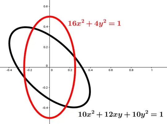

Take the example $10x^2+12xy+10y^2=1$. The quadratic form on the left has matrix $$M := \left(\begin{array}{cc} 10 & 6 \\ 6 & 10 \end{array}\right)$$ The eigenvectors of $M$ are $(1,1)^{\top}$ and $(1,-1)^{\top}$ with corresponding eigenvalues of $16$ and $4$ respectively. That gives $(1/\sqrt 2,1/\sqrt 2)^{\top}$ and $(1/\sqrt 2, -1/\sqrt 2)^{\top}$ as an orthogonal basis, i.e. unit length and perpendicular. Changing to this basis will diagonalise the quadratic form. (The change of basis will be a rotation.) If $$V:=\left(\begin{array}{cc} 1/\sqrt 2 & 1/\sqrt 2 \\ 1/\sqrt 2 & -1/\sqrt 2\end{array}\right) \ \ \ \mbox{and} \ \ \ D:=\left(\begin{array}{cc} 16 & 0 \\ 0 & 4 \end{array}\right)$$ then $MV=VD$. The matrix $V$ is orthogonal, and so $V^{-1}=V^{\top}$ meaning that $D=V^{-1}MV=V^{\top}MV$. If $x = {x\choose y}$ then \begin{eqnarray*} x^{\top}D x &=& x^{\top}V^{\top}MV x \\ \\ &=& (V x)^{\top}M(V x) \end{eqnarray*} A change of coordinates $x \mapsto Vx$ will diagonalise the quadratic form. If we put \begin{eqnarray*} x &=& \frac{1}{\sqrt 2}\,X + \frac{1}{\sqrt 2}\,Y \\ \\ y &=& \frac{1}{\sqrt 2}\, X - \frac{1}{\sqrt 2}\, Y \end{eqnarray*} then $10x^2+12xy+10y^2 \leadsto 16X^2 + 4Y^2$. Meaning that the locus $10x^2+12xy+10y^2=1$ can be rotated to the locus $16x^2+4y^2=1$, which is an ellipse crossing the $x$-axis at $\pm \frac{1}{4}$, and the $y$-axis at $\pm \frac{1}{2}$.

@AnshKumar I've added an example to my post. Hope it helps. Please remember to upvote answer that you find useful. – Fly by Night Feb 08 '17 at 16:35
The eigenvectors of the matrix $M$ gives us the axes of the conic but how would we know which one semi-major or semi-minor axis? Also, how to find the angle of rotation ? – Vedanshu Feb 08 '17 at 16:48
@AnshKumar The semi-major is the longest and the semi-minor is the shortest.$\frac{1}{2}> \frac{1}{4}$. The rotation is given by $x \mapsto Vx$. Compare the matrix $V$ to the standard formula for a rotation, and solve for $\theta$:
$$\left(\begin{array}{cc} \cos \theta & -\sin\theta \ \sin\theta & \cos\theta \end{array}\right) = \left(\begin{array}{cc} 1/\sqrt 2 & 1/\sqrt 2 \ -1/\sqrt 2 & 1/\sqrt 2 \end{array}\right)$$
I get $\theta = -\frac{1}{4}\pi$ which gives a clockwise rotation of $45^{\circ}$.
– Fly by Night Feb 08 '17 at 17:02 -
@AnshKumar You're right that it is $45^{\circ}$, that was my mistake. Think of complex numbers: positive angles go anti-clockwise, so negative angles go clockwise. Your example could be rotated either way. Rotating clockwise by $45^{\circ}$ puts the semi-major axis along the $y$-axis and the semi-minor axis along the $x$-axis. Rotating anti-clockwise by $45^{\circ}$ puts the semi-major axis along the $x$-axis and the semi-minor axis along the $y$-axis. That would swap the $16$ and the $4$ in the matrix $D$, and would give $4x^2+16y^2=1$ instead of $16x^2+4y^2=1$. My choice was $16x^2+4y^2=1$. – Fly by Night Feb 08 '17 at 17:11
@AnshKumar See the picture I've added for more details. The black curve is your original example $10x^2+12xy+10y^2=1$. The red curve is what you get by rotating clockwise (about the origin) by $45^{\circ}$. – Fly by Night Feb 08 '17 at 17:19
