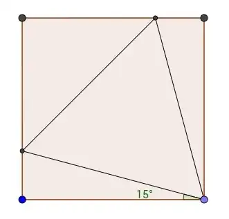

The answer is 15° so stop here if you want to have a go at the proof (not given by the Mathworld link); it's basically trigonometry. I give it here because the result was needed by a friend for making furniture. It's best to start with a good diagram (to be added) but for now imagine a square with side length $A$ containing an equilateral triangle (also of side length $A$) with a horizontal base. The tip of the triangle will not touch the top of the square, but if it is rotated anticlockwise about the origin (at the bottom left) and the base is extended as $H$, the tip will touch the top after rotation $\theta$.
This creates three triangles outside the main triangle. For the one below we have: $$O=H\sin{\theta}$$ For the one to the right we have (for the lowest angle $\phi$): $$\phi=180°-60°-(90°-\theta)=30°+\theta=\frac{\pi}{6}+\theta$$ $$H\cos(\theta+\frac{\pi}{6})=A-O=A-H\sin\theta$$ $$\cos(\theta+\frac{\pi}{6})=\frac{A}{H}-\sin\theta$$ Using the cosine sum identity this yields: $$\cos\theta\cos\frac{\pi}{6}-\sin\theta\sin\frac{\pi}{6}=\frac{A}{H}-\sin\theta$$ Substituting $\cos\theta$ for $A/H$ and rearranging gives: $$\sin\theta=(2-\sqrt{3})\cos\theta$$ $$\theta=\tan^{-1}(2-\sqrt{3})=\frac{\pi}{12}=15°$$
EDIT The area of an equilateral triangle $A_T$ is: $$A_T=\frac{\sqrt{3}}{4}H^2$$ For our case the side length $H$ is: $$H=\frac{A}{\cos(15°)}$$ Therefore: $$A_T=\frac{\sqrt{3}}{4}\times\frac{(2\sqrt{2})^2A^2}{(1+\sqrt{3})^2}=\frac{2\sqrt{3}A^2}{4+2\sqrt{3}}=\frac{\sqrt{3}A^2}{2+\sqrt{3}}$$
The story of why we know that the largest equilateral triangle inscribed in a square is positioned as shown below, can be found in a video here. Just press the green button marked "Video".

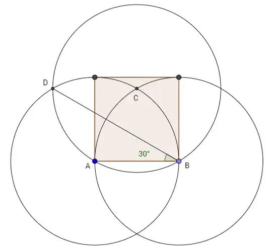

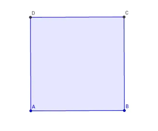

I don't know if Taha Akbari is interested in the other part of the OP question, namely "Can we construct it (with compass and straightedge)?", but I found it interesting. And the answer is yes. It takes $3$ basic steps:
  1. Construct a $30^\circ$ angle from a corner of the square
    See here for an animated version of how this is done. The end result is shown below.

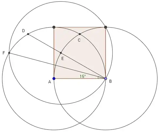

  1. Construct the bisector of the $30^\circ$ angle

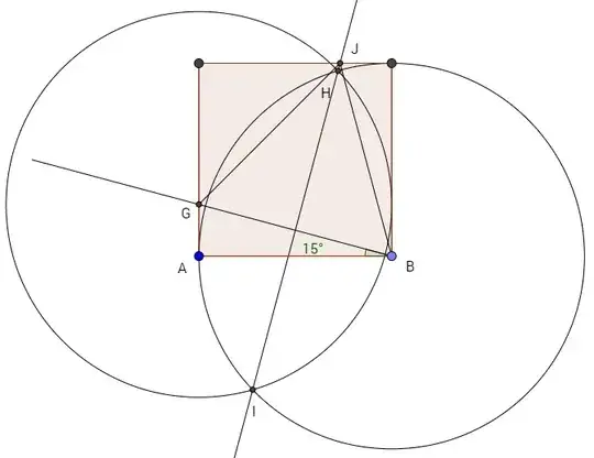

  1. Construct the rest of the equilateral triangle
    a. The intersection of the line BF with the side of the square gives the point G. The line BG is one side of the triangle.
    b. Construct the perpendicular bisector of BG using the intersection points of circles at B and G. Point J, which is the intersection of the bisector with the square, provides the last point of the equilateral triangle $\triangle BGJ$.

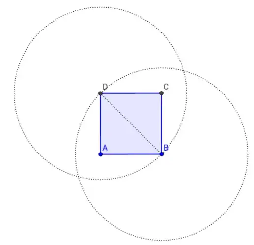

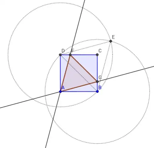

Simplified construction of the triangle:
Draw the diagonal $AC$ and the arcs through $B$ centred on $A$ and through $A$ centred on $B$. The arcs intersect at point $D$ and the arc-diagonal intersection is at point $E$. Draw a circle centred on $D$ through $E$, finding $F$ as the other intersection with the arc.
Draw the line $AF$ and extend to $G$ on the side of the square. Draw an arc centred on $C$ (or $A$) through $G$ to find $H$ as the other intersection with the square. $\triangle AGH$ is the desired triangle.
($\triangle ADB$ is equilateral and $\angle BAC = 45°$ thus $\angle EAD = 15°$ so also $\angle DAF = 15°$.)

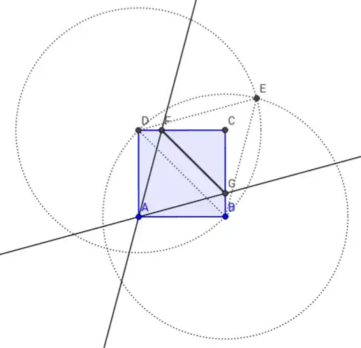

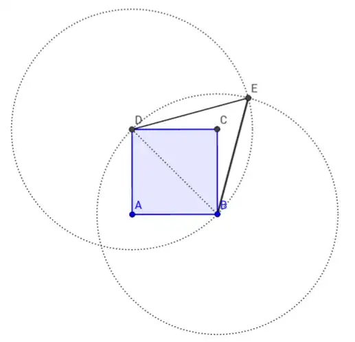

Based on my answer to the question Finding the largest equilateral triangle inside a given triangle, I present the following solution:
  1. Draw the diagonal BD, and draw circles with radius BD at both ends.
  1. Mark E, the intersection of the two circles, and draw intervals EB and ED.
  1. Draw a line parallel to EB through A, marking the intersection with CD at F. Draw a line parallel with ED through A, marking the intersection with BC at G. Then join F to G.
  1. Shade $\triangle$AFG, the required equilateral triangle.
The proof is elementary, since $\triangle$BDE is equilateral, and corresponding angels between parallel lines are equal.
