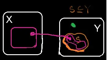

I thought to provide some intuition by virtue of a picture. As drawn, $f$ is NOT surjective, because:
$a \in$ set X. $b, c \in$ set $Y.$ Your $X$ is my $S$ and $S \subsetneq Y$ here.
The pink bespeaks both $f^{-1}(S)$ and $f: X \to Y$ defined by $f(a) = b$. The green point is $c \in Y$.
Then $f(f^{-1}(\{c\}))=f(\varnothing)=\varnothing\neq\{c\}\quad\text{and}\quad f(f^{-1}(Y))=f(\{a\})=\{b\}\neq Y$.
Yet, espy that if I extend/stretch $f(X)$ (in pink inside $S$) to "cover" all of $Y$, then $f(X) = Y$.
By virtue of the definition of surjectivity, this mans $f$ is surjective.
