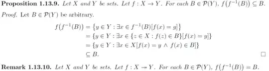

- $\exists$ is the symbol for "there exists."
- $\wedge$ is the symbol for "and."
- $f:X\twoheadrightarrow Y$ is notation for "$f$ is a surjective (onto) function from $X$ to $Y$."
- $\mathcal{P}(Y)$ is notation for "powerset of $Y$" or "the set of all subsets of $Y$."
- "$\subseteq$" becomes "$=$" for onto functions.
