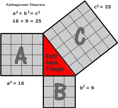

I liked Garfield's Proof. It is simple and intuitive.
Here, https://www.khanacademy.org/math/cc-eighth-grade-math/cc-8th-geometry/cc-8th-pythagorean-proofs/v/garfield-s-proof-of-the-pythagorean-theorem
JohnK
  • 6,796
For geometric proof using rearrangment there are few quite good example on the Wikipedia page. A beginner likely will not understand this quite well, because all those triangles in the picture can be confusing, so I recommend to start first with this "counting proof"
Then introduce the rearrangment pictures and animations, and at last introduce the actual formula $a^2 + b^2 = c^2$. It would be nice to lead them and help them to derive the formula by themselves, rather than just writing it on a board.
