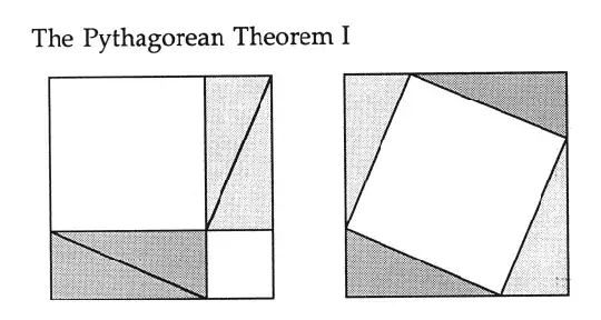

I was intrigued by a book I saw called Proofs without Words. So I bought it, and discovered that the entire book doesn't have any words in it. I figured at least it would have some words explaining the pictures or something to help understand the proofs. I was wrong.
The book gives several picture proofs of the Pythagorean theorem. Attached is the first one. Can someone add a few words (or even just arrows and labels or anything) which would help me understand how this pic proves the theorem (which says, as I know all of you know, that $a^2+b^2=c^2$, where $a$ and $b$ are the lengths of the perpendicular sides of a right triangle, and $c$ is the length of the hypotenuse).

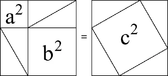

How about just three letters?
$\;\;$ pythag
(Hat tip: Clipart Etc.)

  • Nice succinct answer. Frankly, the original proof I posted would have been just as wordless, but better with just those labels.
    But I think we still need to prove that the four triangles in the left are congruent to the four on the right. They sure look congruent. But I don't think a geometry teacher would accept that answer. How do you prove that part?
    – Jeff Jan 30 '12 at 00:19
    @Jeff: What do you mean congruent? They're all the same triangle with sides $a$ and $b$, hypotenuse $c$ (these are actually the givens and the $a^2,b^2,c^2$ as areas are derived from these givens). – anon Jan 30 '12 at 00:24
  • IOW, How do you know that the ones in the left are the same triangles as the ones in the right? The ones on the right could be triangles which are really close the the ones on the left, they certainly look like the same triangles, but how do we know that they are the same (short of cutting up a piece of paper and sliding the triangles around). – Jeff Jan 30 '12 at 00:34
  • 9
    @Jeff: Because they're defined that way. Those are the givens: the fact that we construct both figures with the same triangle is our starting set of information, from which we derive the areas of the squares as $a^2,b^2,c^2$, and from there we derive $a^2+b^2=c^2$. – anon Jan 30 '12 at 00:38
    Ohhhhhh. I see. Since the triangles are the same on both sides, the white area must be the same. Thanks. – Jeff Jan 30 '12 at 01:07
  • Brilliant. Nice answer. – rcollyer Jan 30 '12 at 02:10
    you could also just symbolically tell the reader that the dimensions of the triangles are the same.... IIRC from math this is how that is done? https://i.sstatic.net/Iaae8.png – rlemon Jan 30 '12 at 02:11
  • What an amazing proof. – Xonatron Jan 30 '12 at 14:58

The light gray and dark gray triangles are all copies of the same right triangle.
The outline of each figure is a square with side length $a+b$; in particular their area is the same. Because both figures contain 4 gray triangles (even in the same orientations on both sides), the total area of the white portions must be the same on both sides. On the left, the white consists of one square of area $a^2$ and another square of area $b^2$. On the right, the white consists of a single square of area $c^2$. Since the total area is the same, we must have $a^2+b^2=c^2$.
  • Good explanation. But I think we still need to prove that the triangles on the left are congruent to the triangles on the right. How? – Jeff Jan 30 '12 at 00:19
  • I think the point is that its up to you to imagine this is possible - then verify that it is true by creating (as a given) the model on the right with triangles that are congruent to the ones of the model on the left side. (Then you should confirm that the quadrilateral in the center is a square, just to be thorough about it!) – Jim Jan 30 '12 at 16:30
Call "a" the short leg of any of the shaded triangles above, and "b" the long leg. Call "c" the hypotenuse.
In the figure on the left, we see two small white squares within the larger square: one small square has sides equal to "a". The other has sides equal to "b". So the area in white on the left is $a^2 + b^2$.
In the figure on the right, we have rearranged the same 4 triangles to new positions with a larger square congruent to the first one. This time we see one white square. Its sides are equal to "c", the hypotenuse. So its area is $c^2$.
The area in white in both triangles must be equal, since all we have done is rearrange the triangles. Since the white areas are equal, $a^2+b^2=c^2$ QED.
  • Thanks Mark. I have the same issue with this proof as with the last Henning's: We still need to prove that the triangles on the left are congruent to the ones on the right (don't we?). – Jeff Jan 30 '12 at 00:19
    they are congruent by Side-Angle-Side. – Mark Beadles Jan 30 '12 at 01:16

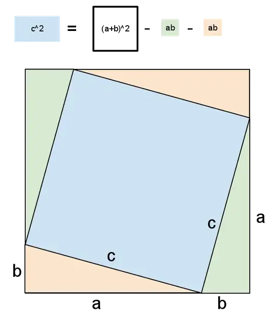

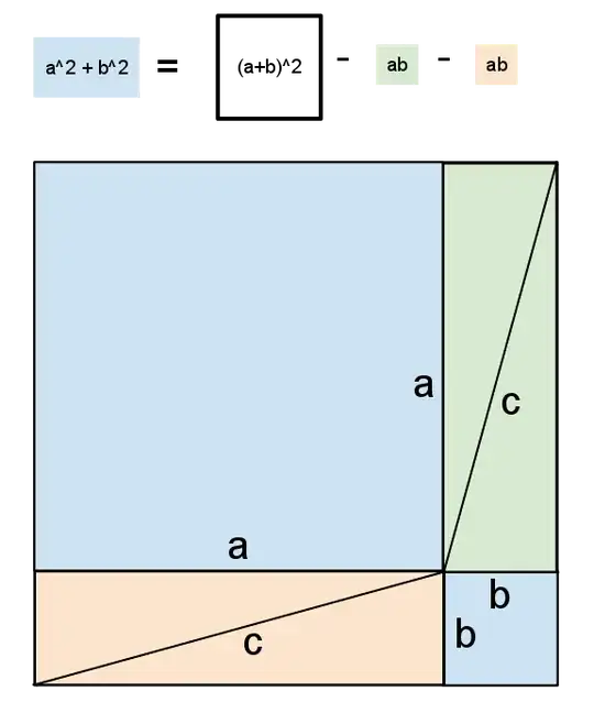

This is a simple way to split a big square (depicted by the large colorless square in the equation) into the smaller green and orange right triangles and blue squares (depicted by colored shapes in the equation)
After moving around the right triangles as in this figure, the two smaller blue squares in earlier picture become a bigger one here. Since the sizes of none of the non-blue shapes have been changed, the blue shapes must certainly add up to the same area (as depicted by the equation)
