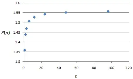

Evidence for my conjecture
I got the following approximations.
$P(1)\approx 1.359$
$P(2)\approx 1.438$
$P(3)\approx 1.469$
$P(6)\approx 1.507$
$P(12)\approx 1.528$
$P(24)\approx 1.543$
$P(48)\approx 1.552$
$P(96)\approx 1.558$
It seems that if the average arc length is less than $\dfrac{e}{2}$ then the product approaches $0$, and if the average arc length is greater than $\dfrac{e}{2}$ then the product approaches $\infty$.
