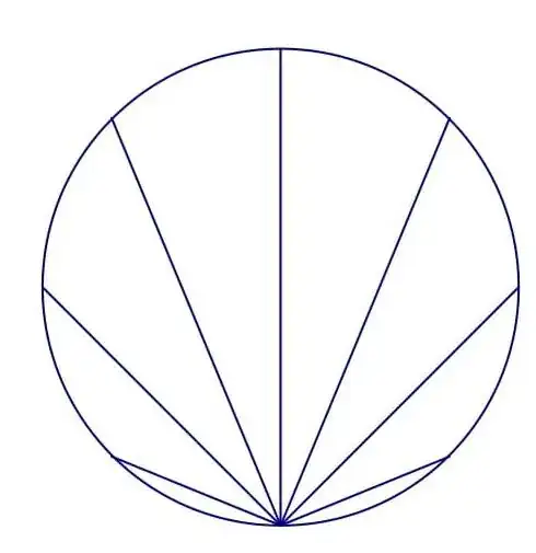

A disk of area $2n$ is divided into $n$ regions by drawing $n$ evenly spaced points on the perimeter and then drawing line segments joining one fixed point with all the other points. An example is shown with $n=8$.
Circle
What is the limit of the product of the areas of the regions, as $n$ approaches $\infty$ ?
Using basic trigonometry, I've got:
$$\lim_{n\to\infty}\prod_{k=1}^{n}\left(2-\frac{n}{\pi}\sin\left(\frac{2k\pi}{n}\right)+\frac{n}{\pi}\sin\left(\frac{2(k-1)\pi}{n}\right)\right)$$
I do not know how to evaluate this limit. Wolfram does not evaluate the limit, but tells me that when $n=10000$ the product is approximately $8.3$.
