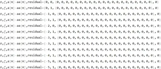

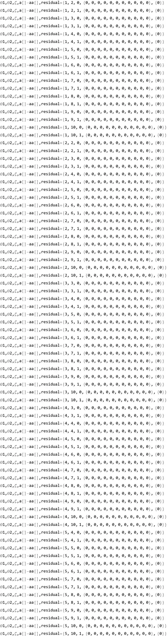

Now we we took $-{\tilde \theta}= 0,1,\cdots,5$ and for each of those values we construct the two independent solutions , i.e. $\zeta=0,1$, and then verify that both of them satisfy the ODE $(I)$. The output is composed of sequences ${\tilde \theta}, \zeta$ then the difference between the coefficients being computed numerically (by solving the recurrence relation) and "analytically" (by using $(II)$) and finally the residual, i.e. the result of the action of the differential operator in $(I)$ on the series expansion where all the terms bigger then a prescribed threshold are being neglected. Here we go:
(*Now replace \[Theta] by 2 \[Theta] in the above. We have:*)
Clear[a, aa, \[Theta], \[Lambda], \[Eta], \[Theta], DD, CC, th, f, g, \
j]; M = 20;
Do[(*Loop over [Theta] ) Do[a[-p] = 0, {p, 1, -2 [Theta]}]; Do[(Loop over [Zeta]*) If[[Zeta] == 1, {a[0], a[1]} = {0, 1}, {a[0], a[1]} = {1, 0}];
f[n_] := (CC [Lambda] )/((n - [Zeta] + 2) (n - [Zeta] + 1 + DD)); g[n_] := - (n - [Zeta] + 2 [Theta])/((n - [Zeta] + 2) (n - [Zeta] + 1 + DD));
(Numerically) Do[ a[n + 2] = f[n] a[n] + g[n] a[n + 2 [Theta]]; , {n, 0, M}];
("Closed form solution") Do[ S = 0; Do[ Do[ If[! (n + 2 - [Zeta] - (2 k - l 2 [Theta]) == 0), Continue[]]; S0 = Which[l == 0, 1, l > 0, Sum[
      Product[Pochhammer[
         j[\[Eta] + 1] - \[Eta] \[Theta] + (\[Zeta] - n - 2)/
          2, -\[Theta] + 1] Pochhammer[
         j[\[Eta] + 1] - \[Eta] \[Theta] + (\[Zeta] - n - 1 - DD)/
          2, -\[Theta]], {\[Eta], 0, l - 1}]
      Evaluate[
       Sequence @@
        Table[{j[\[Eta]], If[\[Eta] == 1, 0, j[\[Eta] - 1]] + 1,
          k}, {\[Eta], 1, l}]]]
   S0 =
    S0 *Product[
      1/((n - \[Zeta] - 2 \[Xi] + 2) (n - \[Zeta] - 2 \[Xi] + 1 +
         DD)), {\[Xi], 0, k - 1 - l \[Theta]}] (CC \[Lambda])^(
     k - l) 2^((-2 \[Theta] + 1) l);
   S += S0;
   , {l, 0, k}];
 , {k, 1, Floor[(n + 2 - \[Zeta])/2]}];
aa[n + 2] = S;
, {n, 0, M}];

Here we provide a new set of solutions, i.e. the local solutions to the eigen-equation of the infinitesimal generator, in the case when $\beta_1 = 1 + \theta (\beta_1-1)$ with $\theta=1,2,3,\cdots$. This is a generalization of the second case of my answer above.
A substitution $y = A z^{1-\beta_1}$ transforms the ODE $(1)$ into the following simpler ODE with integer power law coefficients. We have:
\begin{equation} f^{''}(y) + \left({\mathfrak D} \frac{1}{y} + y^{2 \theta-2} \right) f^{'}(y) - {\mathfrak C} \lambda y^{2 \theta-2} f(y) \tag{II} \end{equation}
where $A= (\frac{(1-\beta_1) \sigma^2}{(2 \mu)})^{\frac{1}{1-2 \theta}}$ then ${\mathfrak D} = \beta_1/(-1+\beta_1)$ and ${\mathfrak C} := \frac{2}{(A^{2\theta}(-1+\beta_1)^2 \sigma^2)}$.
Now we proceed in the same way as before, i.e. we use the Frobenius method to construct power series expansion solutions $f(y):= \sum\limits_{n=0}^\infty a_n y^{n+\alpha}$ . Inserting this into $(II)$ gives(from the left to the right) the following:
\begin{equation} \underline{a_n (n+\alpha)_{(2)} y^{n+\alpha-2} + a_n {\mathfrak D} (n+\alpha)_{(1)} y^{n+\alpha-2}} + a_n(n+\alpha)_{(1)} y^{n+\alpha+2 \theta-3} - {\mathfrak C} \lambda a_n y^{n+\alpha+2 \theta-2} =0 \tag{IIa} \end{equation}
Because $\theta \ge 1$ it is clear that the underlined terms will produce the lowest power exponents. Annihilating those terms at the lowest values of $n$ gives us the indicial equation. Pretty much in the same way as before we have the following two possibilities:
  1. $a_0\neq 0$ and $a_1=0$ and $\alpha_{(2)} + {\mathfrak D} \alpha_{(1)} = 0 $ which gives $\alpha =0$.
  2. $a_0= 0$ and $a_1 \neq0$ and $(1+\alpha)_{(2)} + {\mathfrak D} (1+\alpha)_{(1)} = 0 $ which gives $\alpha =-1$.
The recurrence relation reads, in both cases, as follows:
\begin{equation} a_{n+2} = \frac{{\mathfrak C} \lambda a_{n-\theta_1} - (n+\alpha -\theta_2) a_{n-\theta_2} }{(n+2+\alpha)(n+1+\alpha +{\mathfrak D})} \end{equation} where $(\theta_1,\theta_2) = (2\theta-2, 2\theta-3)$. The recurrence involves, again, three different points and is of the form $a_{n+2}= f_n a_{n-\theta_1} + g_n a_{n-\theta_2}$ subject to either $(a_0,a_1) = (1,0)$ or $(a_0,a_1) = (0,1)$. By similar considerations as in my previous answer above the general solution to that recurrence reads:
\begin{eqnarray} a_{n+2} = a_\zeta \sum\limits_{k=1}^{\lfloor \frac{n+2-\zeta}{2+ \theta_1 \wedge \theta_2} \rfloor} \sum\limits_{l=0}^k \delta_{n+2-\zeta,(2+\theta_1)k + l (\theta_2-\theta_1)} % \sum\limits_{1 \le j_1 < j_2 < \cdots < j_l \le k} \prod\limits_{\eta=0}^l \left( g_{n-(2+\theta_1)(j_{\eta+1}-\eta-1) - \eta (2+\theta_2)} 1_{\eta <l} + 1_{\eta=l} \right) \cdot \prod\limits_{\xi=0}^{j_{\eta+1} -j_\eta-2} f_{n-(2+\theta_1)(j_\eta-\eta+\xi)-\eta(2+\theta_2)} \tag{IIb} \end{eqnarray} where $\zeta=0,1$.
Now we take $(\theta_1,\theta_2) = (2\theta-2,2\theta-3)$ and $(f_n,g_n) = ({\mathfrak C} \lambda,-(n-\zeta-\theta_2))/((n-\zeta+2)(n-\zeta+1+{\mathfrak D}))$ and inserting those into $(IIb)$ we get the final formula for the coefficients. Here we go:
\begin{eqnarray} &&a_{n+2} = a_\zeta \cdot \sum\limits_{k=1}^{\lfloor \frac{n+2-\zeta}{2 \theta-1} \rfloor} \sum\limits_{l=0}^k \delta_{k, \frac{n+l+2-\zeta}{2 \theta}} \cdot \left( \frac{{\mathfrak C} \lambda}{(2\theta)^2} \right)^{k-l} \left( \frac{1}{2 \theta} \right)^l \cdot \sum\limits_{1 \le j_1 < j_2 , \cdots < j_l \le k} \\ && \prod\limits_{\eta=0}^l \frac{1}{ (\frac{n+\eta-\zeta+2}{-2\theta} + j_\eta)^{(j_{\eta+1} - j_\eta - \delta_{eta,l} )}} \cdot \frac{1}{ (\frac{n+\eta-\zeta+1+{\mathfrak D}}{-2\theta} + j_\eta)^{(j_{\eta+1} - j_\eta - \delta_{eta,l} )}} \cdot \prod\limits_{\eta=1}^{l} \left( \frac{n+\eta-\zeta+2}{-2 \theta} + j_\eta \right) \end{eqnarray} for $n=0,1,2,\cdots$. Now the solution to the ODE $(II) $ reads $f(y) = \sum\limits_{n=0}^\infty a_n y^{n-\zeta}$ as the code snippet below demonstrates:
(*Eigenfunctions of the infinitesimal generator: Second case.*)
(*The recurrence to be solved is the one above at \[Theta]1= 2 \
\[Theta]-2 and \[Theta]2 = 2 \[Theta]-3.*)
up[a_, n_] := Pochhammer[a, n];
\[Theta] = RandomInteger[{2, 5}];
\[Zeta] = RandomInteger[{0, 1}]; M = 30;
Do[ Do[ {DD, CC, [Lambda]} = RandomReal[{0, 1}, 3, WorkingPrecision -> 50]; {[Theta]1, [Theta]2} = {2 [Theta] - 2, 2 [Theta] - 3}; Do[a[-p] = 0, {p, 1, 2 [Theta] - 2}]; If[[Zeta] == 1, {a[0], a[1]} = {0, 1}, {a[0], a[1]} = {1, 0}];
(*Use sequence above to construct a general solution to the ODE \
in question.*) f[n_] := ( CC [Lambda] )/((n - [Zeta] + 2) (n - [Zeta] + 1 + DD)); g[n_] := - (n - [Zeta] - [Theta]2)/((n - [Zeta] + 2) (n - [Zeta] + 1 + DD));
(*Numerically*)
Do[
 a[n + 2] = f[n] a[n - \[Theta]1] + g[n] a[n - \[Theta]2];
 , {n, 0, M}];
(*&quot;Closed form solution&quot;
Do[
 S = 0;
 Do[
  Do[
    If[! ((n + l + 2 - \[Zeta])/(2 \[Theta]) == k), Continue[]];
    S0 = Which[
      l == 0, (-1)^k/(k! up[(DD - 1)/(-2 \[Theta]) - k, k]),
      l &gt; 0,
      Sum[
       Product[
         1/up[(n + \[Eta] - \[Zeta] +
             2)/(-2 \[Theta]) + (If[\[Eta] == 0, 0, j[\[Eta]]]),
           If[\[Eta] == l, k, j[\[Eta] + 1]] -
            If[\[Eta] == 0, 0, j[\[Eta]]]] 1/
          up[(n + \[Eta] - \[Zeta] + 1 +
             DD)/(-2 \[Theta]) + (If[\[Eta] == 0, 0, j[\[Eta]]]),
            If[\[Eta] == 0, 0, j[\[Eta]]]] , {\[Eta], 0,
          l}] Product[((
            2)/(-2 \[Theta]) + (j[\[Eta]])), {\[Eta], 1, l}]
       Evaluate[
        Sequence @@
    S +=
     S0 ((CC \[Lambda])/(2 \[Theta])^2)^(k - l) (1/(2 \[Theta]))^l;
    , {l, 0, k}];
  , {k, 1, Floor[(n + 2 - \[Zeta])/(2 \[Theta] - 1)]}];
 aa[n + 2] = S;
 , {n, 0, M}];
diffas = N[Table[(a[n + 2] - aa[n + 2]), {n, 0, M}], 50];
in question.*)
Clear[CC, DD, \[Lambda]];
f[n_] := (
 CC \[Lambda] )/((n - \[Zeta] + 2) (n - \[Zeta] + 1 + DD));
g[n_] := - (n - \[Zeta] - \[Theta]2)/((n - \[Zeta] +
(*Numerically*)
Do[
 , {n, 0, M}];
res = (D[#, {y, 2}] + ( DD 1/y + y^\[Theta]1) D[#, y] -
     CC \[Lambda] y^\[Theta]1 #) &amp; /@ {Sum[
    a[n] y^(n - \[Zeta]), {n, 0, M + 2}]};
res =
 Collect[(Expand[res] /. y^n_ :&gt; 0 /; n &gt;= M), y, Together[#] &amp;];
Print[
 &quot;\[Theta],\[Zeta],a-aa,residual=&quot;, {\[Theta], \[Zeta], diffas,
  res}];
, {\[Zeta], 0, 1}];
, {[Theta], 2, 5, +1}];

We give the eigenfunctions of the infinitesimal generator for another much broader family of processes that includes the first case family as a special case. To be precise we take: $\beta_1-1 = \theta_1/\theta_2 (\beta_2-1)$ where $\theta_{1,2}$ are both integers and $\theta_1 \ge 1$ and $2 \theta_2-\theta_1-2 \ge 0$.
Here the substitution $y = A z^{\frac{1-\beta_2}{\theta_2}}$ leads to the following ODE with integer power law coefficients. We have:
\begin{equation} f^{''}(y) + \left( {\mathfrak D} \frac{1}{y} + y^{2 \theta_2-\theta_1-1}\right) f^{'}(y) - {\mathfrak C} \cdot \lambda f(y) = 0 \tag{III} \end{equation}
where $A = (\frac{\sigma^2 (1-\beta_2)}{2 \mu \theta_2})^{1/(\theta_1-2 \theta_2)}$ then ${\mathfrak D} = 1 + \frac{\theta_2}{-1+\beta_2}$ and ${\mathfrak C} := A^{-2 \theta_2} \theta_2^2 \frac{2}{(-1+\beta_2)^2 \sigma^2}$.
Now we set $f(y) := \sum\limits_{n=0}^\infty a_n y^{n+\alpha}$. Inserting this conjecture into $(III)$ gives the following:
\begin{equation} \underline{ a_n (n+\alpha)_{(2)} \cdot y^{n+\alpha-2} + a_n {\mathfrak D} (n+\alpha)_{(1)} \cdot y^{n+\alpha-2}} + a_n (n+\alpha)^{(1)} y^{n+\alpha-\theta_1+2(\theta_2-1)} + -{\mathfrak C} \cdot \lambda \cdot a_n \cdot y^{n+\alpha} \tag{IIIa} \end{equation}
Now, due to our constraints on $\theta_{1},\theta_2$ it is the underlined terms that yield the smallest power law exponents at $n=0,1$. The indicial equation is therefore determined by annihilating those terms. We have two possibilities:
  1. $a_0\neq 0$, $a_1=0$ and $\alpha_{(2)} + {\mathfrak D} \alpha_{(1)} =0$ which gives $\alpha=0$.
  2. $a_0= 0$, $a_1\neq 0$ and $(1+\alpha)_{(2)} + {\mathfrak D} (1+\alpha)_{(1)} =0$ which gives $\alpha=-{\mathfrak D}$.
The recurrence relation reads in both cases as follows:
\begin{eqnarray} a_{n+2} &=& \frac{{\mathfrak C} \lambda a_n - a_{n+2-(2 \theta_2-\theta_1)}}{(n+2+\alpha)(n+1+\alpha+{\mathfrak D})} \tag{IIIb} \end{eqnarray} where $n=0,1,2,\cdots$ and the initial conditions being either $a_0,a_1,\alpha=1,0,0$ or $a_0,a_1,\alpha=0,1,-{\mathfrak D}$.
Now by using the general solution to a three point recurrence relation (see $(IIb)$ in my second answer to this question) we write down the following "closed form " expression for the coefficients:
\begin{eqnarray} &&a_{n+2} = a_\zeta \sum\limits_{k=1}^{\lfloor \frac{n+2-\zeta}{2+(0 \wedge (-2+2 \theta_2-\theta_1))}\rfloor} \sum\limits_{l=0}^k \delta_{n+2-\zeta,2 k+l(-2+2 \theta_2-\theta_1)} \cdot (\frac{{\mathfrak C} \lambda}{2^2})^{k-l} 2^{-l} \cdot \left( (-1-\frac{\theta_1}{2}+\theta_2)! (-0-\frac{\theta_1}{2}+\theta_2)! \right)^l \cdot \\ && \frac{\Gamma(\frac{n+\epsilon+\alpha+2}{-2})}{\Gamma(\frac{n-l(-2+2\theta_2-\theta_1)+\epsilon+\alpha+2}{-2} + k)} \cdot \frac{\Gamma(\frac{n+\epsilon+\alpha+1+{\mathfrak D}}{-2})}{\Gamma(\frac{n-l(-2+2\theta_2-\theta_1)+\epsilon+\alpha+1+{\mathfrak D}}{-2} + k)} \cdot \\ && \sum\limits_{1 \le j_1 < j_2 < \cdots < j_l \le k} \prod\limits_{\eta=1}^l \binom{\frac{1}{2}(-2-n-\alpha-\epsilon-\eta(2+\theta_1-2 \theta_2)+2 j_\eta)}{-0-\frac{\theta_1}{2}+\theta_2} \binom{\frac{1}{2}(-3-{\mathfrak D}-n-\alpha-\epsilon-\eta(2+\theta_1-2 \theta_2)+2 j_\eta)}{-1-\frac{\theta_1}{2}+\theta_2} \tag{IIIc} \end{eqnarray} where $\zeta=0,1$ and $\alpha = 0$ or $\alpha=-{\mathfrak D}$ when $\zeta=0$ or $\zeta=1$ respectively. Again, when $\theta_1$ is even then the multiple sum can be done in closed form by using the results from here. The eigenfunctions are then constructed from the ansatz as follows $f(y)= \sum\limits_{n=0}^\infty a_n y^{n+\alpha}$.
The code snippet below verifies the solution in question. Here we go:
(*Eigenfunctions of the infinitesimal generator: Third case.\[Beta]1 \
= 1+\[Theta]1/\[Theta]2 (\[Beta]2-1);*)
(* We have:*)
Clear[a, aa, \[Theta]1, \[Theta]2, \[Lambda], \[Epsilon], DD, CC, f, \
g, z, y]; M = 10; mmax = 5;
 (*Assumption: 2-2 \[Theta]2+\[Theta]1 <=0 and Element[\[Theta]2|\
\[Theta]1, Integers]*)
Do[Do[
    Do[
      Do[a[-p] = 0, {p, 1, 2 Max[\[Theta]1, \[Theta]2]}];
      If[\[Zeta] ==
        0, {a[0], a[1], \[Alpha]} = {1, 0, 0}, {a[0],
         a[1], \[Alpha]} = {0, 1, -DD}];
  f[n_] := (
   CC  \[Lambda] )/((n + \[Epsilon] + \[Alpha] +
      2) (n + \[Epsilon] + \[Alpha] + 1 + DD));
  g[n_] := - (n + \[Epsilon] + \[Alpha] + 2 -
      2 \[Theta]2 + \[Theta]1)/((n + \[Epsilon] + \[Alpha] +
  (*Numerically*)
  Do[
   a[n + 2] = f[n] a[n] + g[n] a[n + 2 - 2 \[Theta]2 + \[Theta]1];
   , {n, 0, M}];
  (*&quot;Closed form solution&quot;*)
  If[False,
   (*Insert (*Some old code.*) from above if needed.*)
   (*Here \[Theta]1 is odd.*)
   Do[
     S = 0;
     Do[
      Do[
        If[! (n +
             2 - \[Zeta] - ((2 + 0) k +
               l (-2 + 2 \[Theta]2 - \[Theta]1 - 0)) == 0),
         Continue[]];
        S0 = Which[
          l == 0, 1,
          l &gt; 0,
          Sum[
           Product[Binomial[
              1/2  (-2 -
                n - \[Alpha] - \[Epsilon] - \[Eta]  (2 + \
[Theta]1 - 2 [Theta]2) + 2 j[[Eta]]), -([Theta]1/ 2) + [Theta]2] Binomial[ 1/2 (-3 - DD - n - [Alpha] - [Epsilon] - [Eta] (2 +
[Theta]1 - 2 [Theta]2) + 2 j[[Eta]]), -1 - [Theta]1/ 2 + [Theta]2] , {[Eta], 1, l}] , Evaluate[ Sequence @@ Table[{j[[Eta]], If[[Eta] == 1, 0, j[[Eta] - 1]] + 1, k}, {[Eta], 1, l}]]] ];
        S += S0 ((CC \[Lambda])/2^2 )^(
          k - l) (2)^-l Gamma[(n + \[Epsilon] + \[Alpha] + 2)/-2]/
          Gamma[(n - (l) (-2 +
                2 \[Theta]2 - \[Theta]1) + \[Epsilon] + \[Alpha] \
  • 2)/-2 + k] ( Gamma[(n + [Epsilon] + [Alpha] + 1 + DD)/-2] ((-1 - [Theta]1/ 2 + [Theta]2)! (-0 - [Theta]1/2 + [Theta]2)!)^ l)/Gamma[( n + [Epsilon] - (l) (-2 + 2 [Theta]2 - [Theta]1) + [Alpha] + 1 + DD)/-2 + k]; , {l, 0, k}]; , {k, 1, Floor[(n + 2 - [Zeta])/( 2 + Min[0, -2 + 2 [Theta]2 - [Theta]1])]}]; aa[n + 2] = S; , {n, 0, M}]; ];
    amaa = FullSimplify[Table[(a[n + 2] - aa[n + 2]), {n, 0, M}]];
in question.*) res = (D[#, {y, 2}] + ( DD 1/y + y^(2 [Theta]2 - [Theta]1 - 1)) D[#, y] - CC [Lambda] #) & /@ {Sum[ a[n] y^(n + [Alpha]), {n, 0, M + 2}]}; res = res /. [Epsilon] :> 0; res1 = Collect[(Expand[res] /. y^n_ :> 0 /; n + DD >= M || n >= M), y, Together]; Print[ "[Theta]1,[Theta]2,[Zeta],a[]-aa[],residual=", {[Theta]1,
[Theta]2, [Zeta], amaa, res1}];
  , {\[Zeta], 0, 1}];
, {\[Theta]2, Ceiling[(\[Theta]1 + 2)/2], 2 mmax}];
, {[Theta]1, 1, mmax}];
