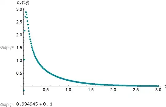

Now we took the following process parameters $\mu,\sigma,\beta = 3/2,1/2,5/2$ and the first value and the barrier $x,y = 3/2, 5/2 $ and we plotted the quantity $(5)$ below. We also verified the normalization numerically. Here we go:
{\[Mu], \[Sigma], \[Beta]} = {3/2, 1/2, 5/2};
(*Here x\[LessEqual]y*)
{x, y} = {3/2, 5/2};
SetOptions[FindRoot, WorkingPrecision -> mprec, PrecisionGoal -> prec]; mzeros = [Lambda] /. Table[FindRoot[ HypergeometricU[-[Lambda], 1 + 1/(2 (-1 + [Beta])), ([Mu] y^( 2 - 2 [Beta]))/((-1 + [Beta]) [Sigma]^2)] == 0, {[Lambda], n}], {n, 0, 50}]; mzeros = Sort[#[[1]] & /@ Tally[mzeros]];
ts = Array[# &, {300}, {1/100, 3}]; vals = {#, Total[Table[ HypergeometricU[-mzeros[[p]], 1 + 1/(2 (-1 + [Beta])), ([Mu] x^( 2 - 2 [Beta]))/((-1 + [Beta]) [Sigma]^2)]/ !(*SuperscriptBox[(HypergeometricU), TagBox[ RowBox[{"(", RowBox[{"1", ",", "0", ",", "0"}], ")"}], Derivative], MultilineFunction->None])[-mzeros[[p]], 1 + 1/(2 (-1 + [Beta])), ([Mu] y^( 2 - 2 [Beta]))/((-1 + [Beta]) [Sigma]^2)] (2 (-1 +
[Beta]) [Mu]) Exp[-2 (-1 + [Beta]) [Mu] mzeros[[p]] #], {p, 1, Length[mzeros]}]]} & /@ ts; ListPlot[vals, PlotRange :> All, AxesLabel -> {"t", "!(*SubscriptBox[(n), (x)])(t,y)"}] f = Interpolation[vals]; NIntegrate[f[xi], {xi, 0.01, 3}]
As you can see the distribution in question has a correct shape and a correct normalization. The negative values close to the origin are due to a numerical error.

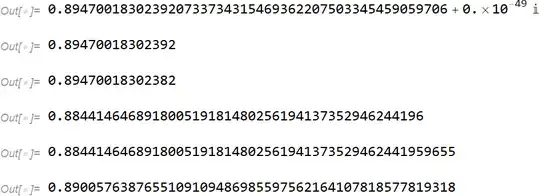

prec = 50;
NN = 100 + 1/10;
SetOptions[NIntegrate, WorkingPrecision -> 15, PrecisionGoal -> 10];
{lmb, mu} = RandomReal[{0, 1}, 2, WorkingPrecision -> prec];
th = RandomReal[{1, 2}, WorkingPrecision -> prec];
x = RandomReal[{0, 1}, WorkingPrecision -> prec];
y = RandomReal[{x, 2}, WorkingPrecision -> prec];
(x/y)^(-lmb/mu) HypergeometricU[lmb/mu NN, NN, NN (th) x^(-1/NN)]/
  HypergeometricU[lmb/mu NN, NN, NN (th) y^(-1/NN)]
(Use the integral representation from
https://en.wikipedia.org/wiki/Confluent_hypergeometric_function#
Integral_representations and substitute in it for z t.
) NIntegrate[ Exp[-t] t^(lmb/mu NN - 1) (1 + t/(NN th ) x^(1/NN))^( NN (1 - lmb/mu - 1/NN)), {t, 0, Infinity}]/ NIntegrate[ Exp[-t] t^(lmb/mu NN - 1) (1 + t/(NN th ) y^(1/NN))^( NN (1 - lmb/mu - 1/NN)), {t, 0, Infinity}]
(Substitute in the above for v= (1+ t/(NN th )x^(1/NN))^(-1)) (x/y)^(-lmb/ mu) NIntegrate[ (E^(-((th (1 - v) x^(-1/NN))/v)) (1 - v)^(lmb/ mu)/v)^NN (1 - v)^-1, {v, 0, 1}]/ NIntegrate[ (E^(-((th (1 - v) y^(-1/NN))/v)) (1 - v)^(lmb/mu)/v)^ NN (1 - v)^-1 , {v, 0, 1}]
(Apply the stationary point approximation) v =.; f[x_, v_] := (th (1 - v) x^(-1/NN))/v - Log[(1 - v)^(lmb/mu)/v]; vstar1 = (v /. FindRoot[D[f[x, v], v] == 0, {v, 1/2}]); vstar2 = (v /. FindRoot[D[f[y, v], v] == 0, {v, 1/2}]); vstar = (-mu - mu th + Sqrt[mu] Sqrt[mu + 4 lmb th - 2 mu th + mu th^2])/(2 (lmb - mu));
(* num=Exp[-NN f[x,vstar]]Sqrt[2 Pi/(NN f[x,vstar])]; denom=Exp[-NN f[y,vstar]]Sqrt[2 Pi/(NN f[y,vstar])]; *) num = Exp[-NN f[x, vstar]]; denom = Exp[-NN f[y, vstar]]; (x/y)^(-lmb/mu) num/denom
(x/y)^(-lmb/mu) Exp[ 1/2 (-1 + th - Sqrt[mu (-1 + th)^2 + 4 lmb th]/Sqrt[ mu]) NN (x^(-1/NN) - y^(-1/NN))]
(x/y)^((-1/2 th + 1/2 + Sqrt[ lmb th/(mu) + (-1/2 th + 1/2)^2]) - lmb/mu)
