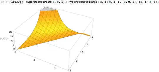

Now we plot the ${\mathfrak h}_{a,b}$ function below and we indeed see that it is positive and that it hits zero when $b=1+a$. Here we go:
So , on the face of it, we have proven our conjecture for all $0< x \le 1$.
