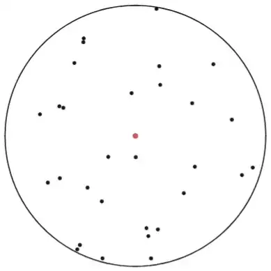

I made a Desmos graph that generates $30$ uniformly random black points in a disk, with the centre of the disk in red.
I asked myself, "Can I always draw a convex quadrilateral with four of the random points as vertices, such that its interior contains the centre of the disk but does not contain any of the random points?" The answer seems to be yes, based on experimentation.
Then I asked myself the same question, except with "quadrilateral" replaced by pentagon, hexagon, or heptagon, and the answer still seems to be always yes.
