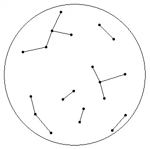

A disc contains $n$ independent uniformly random points. Each point is connected by a line segment to its nearest neighbor, forming clusters of connected points.
For example, here are $20$ random points and $7$ clusters, with an average cluster size of $\frac{20}{7}$.
What does the average cluster size approach as $n\to\infty$ ?
My attempt:
I made a random point generator that generates $20$ random points. The average cluster size is usually approximately $3$.
I considered what happens when we add a new random point to a large set of random points. Adding the point either causes no change in the number of clusters, or it causes the number of clusters to increase by $1$ (Edit: this is not true, as noted by @TonyK in the comments). The probability that adding a new point increases the number of clusters by $1$, is the reciprocal of the answer to my question. (Analogy: Imagine guests arriving to a party; if 25% of guests bring a bottle of wine, then the expectation of the average number of guests per bottle of wine is $4$.) But I haven't worked out this probability.

    Adding a new point can actually decrease the number of clusters. For instance, consider points on the $x$-axis at $0,4,9,$ and $13$: they form two clusters, ${0,4}$ and ${9,13}$. Now add a point at $x=6$: these five points form a single cluster. – TonyK Jan 15 '24 at 16:16

This is Stars in the universe - probability of mutual nearest neighbors in disguise. If there are $k$ pairs of mutual nearest neighbours, then there are $n-k$ edges (since $n$ edges are drawn and $k$ of them occur twice). There can’t be any cycles (unless it’s an Escher disk) because the distances would have to decrease all along the cycle. So the graph is a forest of $n-(n-k)=k$ trees. For $n\to\infty$, the fraction of points that are their nearest neighbour’s nearest neighbour goes to the probability for that to happen; $\frac kn$ is half that fraction, and the expected average cluster size is the reciprocal of that. In two dimensions, that yields
$$ 2\left(\frac43+\frac{\sqrt3}{2\pi}\right)\approx3.218\;. $$

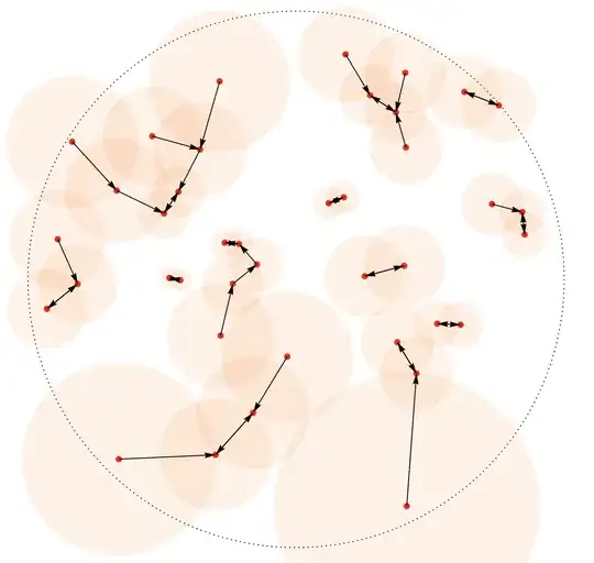

This is a community wiki answer to provide a graphical demonstration of @joriki's idea. (Feel free to expand this!)
In the image below, we generated $40$ random points. Then, from each point $x$, an arrow is drawn to its nearest neighbor $y$ along with the translucent disk of radius $\overline{xy}$ centered at $x$:
Simulation
It is clear from the picture that each graph contains exactly one "mutual arrow", visually confirming joriki's observation.

Fun fact: As the number of points approaches infinity, the sum of areas of the pink discs approaches the area of the big disc (on which the points are randomly located). Here is an intuitive explanation.
