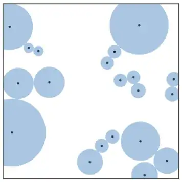

A square lamina contains $n$ independent uniformly random points. At a given time, each point becomes the centre of a disc whose radius grows from $0$, at say $1$ cm per second, and stops growing when the disc hits another disc.
Consider the discs after all growth has stopped. Here is an example with $n=20$.
Let $P=$ proportion of the square that is covered (i.e. occupied) by the discs. In the example above, $P\approx0.383$.
What does $P$ approach as $n\to\infty$ ?
The shape of the lamina (for example, square) does not matter, since we are taking $n\to\infty$. The rate of growth (for example, $1$ cm per second) does not matter, as long as all the discs start growing at the same time and grow at the same rate.
My thoughts
I tried to find the probability that a new random point in the square lies in one of the existing discs. I also tried to find the average area of a disc. But I haven't succeeded. These questions seem to be complicated by the fact that the size of a point's disc is determined not only by the point's distance to its neighbors, but also its neighbors' distances to their neighbors, and so on.

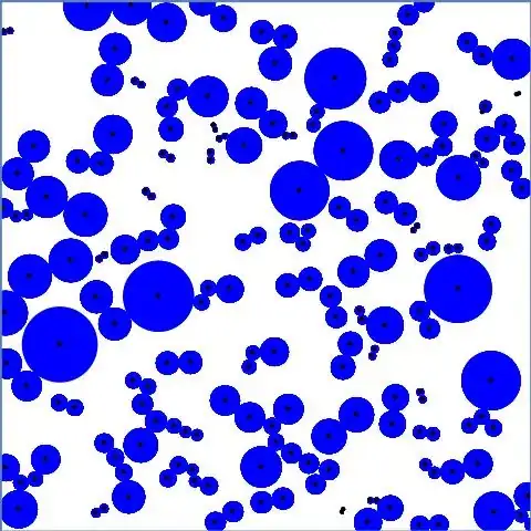

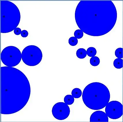

Attached a MATHEMATICA script which generates a set of random circles as needed. The calculation process could be more efficient but it would also be less transparent.
data = {{1.0032, 0.1304},{0.8713, 0.0446}, {0.8458,0.2497},
{0.6789, 0.2751}, {0.6137, 0.2179},
{0.5437, 0.1209}, {1.0398, 0.5311},
{1.0525, 0.6202}, {0.8347, 0.5502},
{0.8061, 0.6297}, {0.7202, 0.6170},
{0.6487, 0.7219}, {0.6964, 0.7839},
{0.8442, 0.9461}, {0.0763, 0.2990},
{0.1160, 0.5915}, {0.2941, 0.5979},
{0.2305, 0.7871},{0.1717, 0.8078},
{0.0556,0.9334}};
boundary = {{0.0270, 0.0250}, {1.0764, 0.0250},
{1.0780, 1.0744}, {0.0238,1.0744}, {0.0270,0.0250}};
(**********************************) SeedRandom[1]; data = RandomReal[{-1, 1}, {200, 2}]; boundary = {{-1, -1}, {1, -1}, {1, 1}, {-1, 1}, {-1, -1}}; (**********************************)
{X, Y} = Transpose[boundary]; xmin = Min[X]; xmax = Max[X]; ymin = Min[Y]; ymax = Max[Y]; n = Length[data];
gr1 = ListPlot[data, PlotStyle -> Black]; gr2 = ListLinePlot[boundary, PlotStyle -> Thick];
circs = Table[{data[[k]], 0, 0}, {k, 1, n}]; For[i = 1, i <= n, i++, For[j = i + 1, j <= n, j++, dist[i, j] = Norm[circs[[i, 1]] - circs[[j, 1]]]]]
minDist[circs_] := Module[{n = Length[circs], d, dmin = Infinity, pi, pj, i, j, i0, j0}, For[i = 1, i <= n, i++, For[j = i + 1, j <= n, j++, If[circs[[i, 3]] == 1 && circs[[j, 3]] == 1, Continue[]]; d = dist[i, j] - circs[[i, 2]] - circs[[j, 2]]; If[d <= dmin, dmin = d; pi = circs[[i]]; pj = circs[[j]]; i0 = i; j0 = j]; ]; ]; Return[{dmin, i0, j0, pi, pj}] ]
dmin = 0; grs = {}; While[dmin < Infinity, {dmin, i0, j0, pi, pj} = minDist[circs]; If[dmin == Infinity, Continue[]]; If[pi[[3]] == 0 && pj[[3]] == 0, circs[[i0, 2]] += dmin/2; circs[[j0, 2]] += dmin/2; circs[[i0, 3]] = 1; circs[[j0, 3]] = 1; For[k = 1, k <= n, k++, If[circs[[k, 3]] != 1, circs[[k, 2]] += dmin/2] ]]; If[circs[[i0, 3]] == 1 && circs[[j0, 3]] == 0, circs[[j0, 2]] += dmin; circs[[j0, 3]] = 1; For[k = 1, k <= n, k++, If[circs[[k, 3]] != 1, circs[[k, 2]] += dmin]] ]; If[circs[[j0, 3]] == 1 && circs[[i0, 3]] == 0, circs[[i0, 2]] += dmin; circs[[i0, 3]] = 1; For[k = 1, k <= n, k++, If[circs[[k, 3]] != 1, circs[[k, 2]] += dmin]] ]; grcircs = Table[Graphics[{Blue, Disk[circs[[k, 1]], circs[[k, 2]]]}, PlotRange -> {{xmin, xmax}, {ymin, ymax}}, PlotRangeClipping -> True], {k, 1, n}]; AppendTo[grs, grcircs]; ];
Show[grs, gr1, gr2, PlotRange -> {{xmin, xmax}, {ymin, ymax}}, PlotRangeClipping -> True]
The proposed setup.
A random setup

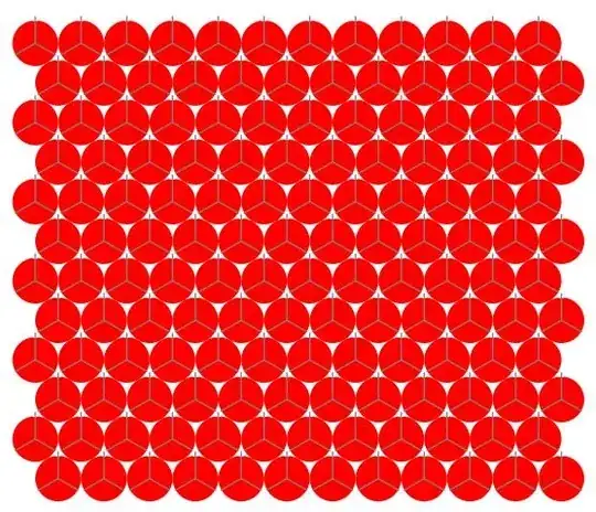

My guess is that the maximum ratio is achieved with a honeycomb structure, going to the limit. From Lagrange $\frac{\pi}{2\sqrt{3}}$.
Cesareo
  • 36,341
  • The maximum isn't attained by the honeycomb structure, because we can put two very close points in the center of each triangular void and gain additional area. Iterating this procedure will let you get density $1$. – RavenclawPrefect Jan 27 '24 at 00:45
  • I think there is something wrong with the first image (with the dark blue disks). There is a general rule: If a disk, call it $A$, touches exactly one other disk, call it $B$, then $B$ cannot be bigger than $A$. But this rule is not always obeyed in the image. – Dan Jan 27 '24 at 06:23
  • @Dan I hope I have fixed the problems with the drawing algorithm. – Cesareo Feb 04 '24 at 18:28
  • @Cesareo Yes, it looks correct now. – Dan Feb 05 '24 at 00:36
  • @RavenclawPrefect It seems that from Lagrange, the maximum packing density is $\frac{\pi}{2\sqrt{3}}$ roughly $0.907$. – Cesareo Feb 07 '24 at 08:49
  • @Cesareo I believe you’re assuming equal radii, but we have no such guarantee; the density can get arbitrarily close to 1 with the approach I described. – RavenclawPrefect Feb 07 '24 at 20:15
  • @RavenclawPrefect In the limit, the number of points goes to $\infty$ and the distance between points goes to $0$ but the honeycomb relationship establishes a density limit. So the process limit will give us a density less than the honeycomb. – Cesareo Feb 07 '24 at 20:44
