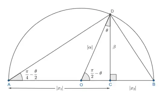

If the formulas are to be understood in the context of real trigonometry (rather than complex trigonometry), we must assume that $a$ and $c$ have the same sign; otherwise we would not be able to take the square root of $\dfrac ca.$ So in this answer I will consider only this case.
Let $\alpha = \dfrac{b}{2a}$ and $\beta = \sqrt{\dfrac ca}.$ Then $\dfrac{b}{2\sqrt{ac}} = \dfrac\alpha\beta$ and $ax^2 + bx + c$ is equivalent to $$ x^2 + 2\alpha x + \beta^2. $$
The roots of the quadratic, $x_1$ and $x_2,$ both have the opposite sign from $\alpha.$ Their sum is $-2\alpha$ and their product is $\beta^2.$ So we can assign the magnitudes of these various quantities to parts of the semicircle shown below:
That is, the radius of the semicircle is $\lvert\alpha\rvert,$ the diameter is $\lvert x_1\rvert + \lvert x_2\rvert = \lvert2\alpha\rvert,$ and if we place point $C$ on the diameter so that $AC = \lvert x_1\rvert$ and $BC = \lvert x_2\rvert$ and construct $CD$ perpendicular to $AB$ with $D$ on the semicircle, $CD = \beta = \sqrt{x_1 x_2}.$
Consider the case where $\alpha > 0.$ If we then let $\theta = \angle CDO,$ then $\theta = \operatorname{arcsec}\left(\dfrac\alpha\beta\right) = \operatorname{arcsec}\left(\dfrac{b}{2\sqrt{ac}}\right).$ Then $\angle COD = \dfrac\pi2 - \theta$ and by the inscribed angle theorem, $\angle BDC = \angle CAD = \dfrac\pi4 - \dfrac\theta2.$ Therefore $\lvert x_1\rvert = \beta \cot\left(\dfrac\pi4 - \dfrac\theta2\right)$ and $\lvert x_2\rvert = \beta \tan\left(\dfrac\pi4 - \dfrac\theta2\right),$ but since $x_1$ and $x_2$ are both negative in this case, $$ x_1 = -\beta \cot\left(\dfrac\pi4 - \dfrac\theta2\right) \quad\text{and}\quad x_2 = -\beta \tan\left(\dfrac\pi4 - \dfrac\theta2\right). $$
According to the formula for the tangent of a difference of angles, $$ \tan\left(\dfrac\pi4 - \dfrac\theta2\right) = \frac{\tan\dfrac\pi4 - \tan\dfrac\theta2}{1 + \tan\dfrac\pi4 \tan\dfrac\theta2} = \frac{1 - \tan\dfrac\theta2}{1 + \tan\dfrac\theta2}. $$
The formulas for the roots then become $$ x_1 = \frac{\tan\dfrac\theta2 + 1}{\tan\dfrac\theta2 - 1} \sqrt{\dfrac ca} \quad\text{and}\quad x_2 = \frac{\tan\dfrac\theta2 - 1}{\tan\dfrac\theta2 + 1} \sqrt{\dfrac ca}, $$ which can be manipulated algebraically into to the formulas shown in the question.
In the case where $\alpha < 0,$ then we can reassign the angles in the figure so that $\angle CDO = \pi - \theta$ where $\theta = \operatorname{arcsec}\left(\dfrac{b}{2\sqrt{ac}}\right).$ Then $\angle COD = \theta - \dfrac\pi2$ and $\angle CAD = \dfrac\theta2 - \dfrac\pi4$. But $$ \tan\left(\dfrac\theta2 - \dfrac\pi4\right) = -\tan\left(\dfrac\pi4 - \dfrac\theta2\right) = \frac{\tan\dfrac\theta2 - 1}{\tan\dfrac\theta2 + 1}, $$ and since $x_1$ and $x_2$ are positive this time, after some algebra we get the same formulas for them in the end as before.
The trigonometric formula in the Wikipedia article for the "positive" case is based on the same figure, but with $\angle COD = 2\theta_p.$ Your formula is therefore just a variation that presumably could be obtained from the formula in Wikipedia by trigonometric identities, although it's not an obvious derivation. Also note that your formula requires more calculation, which is one reason you are less likely to find it documented as a solution of a quadratic equation (given the traditional use of trigonometric substitution in table-assisted calculation).
Another difference between your approach and the one in Wikipedia is that the Wikipedia formula requires using two solutions of the equation $\sin(2\theta) = -2 \dfrac{\sqrt{ac}}{b},$ whereas you use only the pseudoinverse function arcsec, which provides only one value, and then you use sign changes to get the two roots. So your nethod is more explicit, although I think I would prefer it in the form $$ \frac{\tan\dfrac\theta2 \pm 1}{\tan\dfrac\theta2 \mp 1} \sqrt{\frac ca} $$ because it is a bit more obvious how the trigonometric formula in the "$+$" case is the reciprocal of the "$-$" case.
To handle the case where the first and last coefficients of the quadratic have opposite signs, you will either need to modify your formulas or go to trigonometric functions of complex numbers, which makes the geometric derivation more difficult but can still be treated algebraically.
As a side note, in the figure above, $OC = \sqrt{\alpha^2 - \beta^2}.$ If $a > 0$ and $b < 0,$ we then get $$ x_{1,2} = \lvert\alpha\rvert \pm \sqrt{\alpha^2 - \beta^2} = \frac{-b \pm \sqrt{b^2 - 4ac}}{2a}, $$ the well-known solution of the quadratic equation.

  • Thank you for providing an alternative derivation. I deemed it unnecessary to assume that $a$ and $b$ have the same sign, as not assuming so would lead to a product of complex numbers that must yield the roots. For example, consider the equation $x^2-2x-15=0$. Wolfram Alpha gives one of the roots using my formula. – Emmanuel José García Jan 15 '24 at 11:59
  • Of course, this is one of those cases where I would not use my formula and would prefer to use the traditional formula or factorization. – Emmanuel José García Jan 15 '24 at 12:00
  • When you say that my formula requires more calculation, do you mean that deriving it is more complicated than the formulas in the Wikipedia article, or that my formula involves more steps when calculating roots compared to the formulas in the article? – Emmanuel José García Jan 15 '24 at 12:02
  • Either way, if it's the latter, my purpose in deriving this formula is not to streamline calculations like 19th-century astronomers but to incorporate them into a unified theoretical framework based on half-angle formulas. As mentioned earlier, by using substitutions such as $\cos{\theta}$ and $\csc{\theta}$ instead of $\sec{\theta}$, you can obtain the Simons formulas mentioned above, as well as the formulas cited by njuffa, respectively. – Emmanuel José García Jan 15 '24 at 12:02
