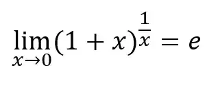

I'm solving some limits and in one of my examples I need to use the fact that:
I am, however, unable to prove that this is actually true. I believe I can't just substitue t=(1/x) because than we can not say where such t is going. I tried to find the proof online, but they all rely on L'Hôpital's rule, which I am trying to avoid. How can I prove this equality without it?

  • You dont. It's the definition of $e$. You can prove it converges to something (by noting it is bounded above yet increasing. Then you declare that what it converges to is $e$. – fleablood Mar 14 '20 at 17:11
  • What I'm trying to show is that it follows from lim(x->∞)(1+(1/x))^x. This is my definition of e. – Jesus Mar 14 '20 at 17:13
  • Just replace $\frac 1x$ with $y$. As $\lim_{y\to \infty}(1+\frac 1y)^{y} = \lim_{x\to \infty}(1+ x)^{\frac 1x}=e$ – fleablood Mar 14 '20 at 17:16
  • But where is y going then; is it going towards ∞ or -∞? If we define y like that (y=1/x as x->0), it does not converge? – Jesus Mar 14 '20 at 17:18
  • Do both. $\lim_{x\to 0^-} (1+x)^{\frac 1x} = \lim_{x\to 0^+}\frac 1{(1-x)^{\frac 1x}}=\lim_{y\to -infty}(1 + \frac 1y)^{y}$ And $\lim_{x\to 0^+}(1+x)^{\frac 1x}\lim_{y\to +infty}(1 + \frac 1y)^{y}$. Show they that $\lim_{y\to -infty}(1 + \frac 1y)^{y}=e$. – fleablood Mar 14 '20 at 17:37
  • Just to make sure, if I do both, is the proof then correct and complete? – Jesus Mar 14 '20 at 17:40

Write it as $(1+\frac{1}{n})^n$ and get the binomial expansion $\sum_{k=0}^n\frac{n(n-1)...(n-k+1)}{n^k}\frac{1}{k!}$. As $n\to \infty$, expansion converges to infinite series for $e=\sum_{k=0}^\infty\frac{1}{k!}$
Note: this is way I first learnt it in high school.
We will first prove a supporting result using sandwich theorem
$$ \begin{align} \frac{x}{x+1} &< \ln(1+x) < x &\text{for $x > -1$} \end{align} $$ See this reference.
$$ \lim_{x \to 0} \frac{1}{x+1} < \lim_{x \to 0} \frac {\ln(1+x)}{x} < \lim_{x \to 0} 1 $$
$$ \Rightarrow \lim_{x \to 0} \frac {\ln(1+x)}{x}=1 $$
And now we can solve the limit in the question. $$ \lim_{x \to 0}(1+x)^{\frac{1}{x}} = e^{\lim_{x \to 0}\frac {\ln(1+x)}{x}}=e $$

Let $g(y) = \frac 1y$. $\lim_{y\to \infty} g(y) = 0$. Thus if $\lim_{k\to\infty} f(k) = \lim_{g(k)\to 0} f(k)$.
$\lim_{x\to 0}(1 + x)^{\frac 1x}$. Replace $x$ with $g(y)$
$\lim_{g(y)\to 0}(1+g(y))^{\frac 1{g(y)}}=$
$\lim_{g(y)\to 0}(1+\frac 1y)^y=$
$\lim_{y\to \infty}(1+\frac 1y)^y =e$
