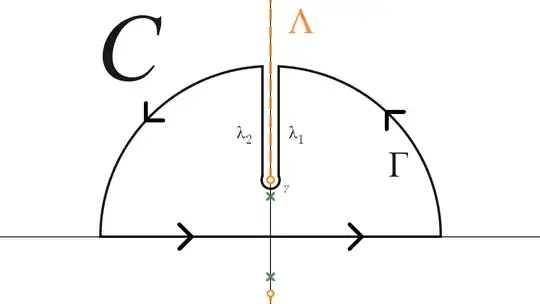

Let $f(z)$ be the integrand as a function of $z$. We can write it as $$ \begin{align} f(z) &= \frac{\log\left(z+i\right)+\log\left(z-i\right)}{2z^{2}+1} \\ &= \frac{1}{2z^{2}+1}\cdot\left(\ln\left|z+i\right|+\ln\left|z-i\right|+i\arg\left(z+i\right)+i\arg\left(z-i\right)\right) \\ \end{align} $$ where we can justify splitting $\log\left(z^2+1\right)$ by defining $\arg(z-i) \in (\pi/2, 5\pi/2)$ and $\arg(z+i) \in (-5\pi/2, -\pi/2)$. We integrate over the following keyhole contour $C$ illustrated below.
Keyhole Contour C
This contour has a radius of $R$. The green x symbols are the poles $i/\sqrt{2}$ and $-i/\sqrt{2}$ and the branch cuts are highlighted in orange. And $\Gamma$ is the union of the two outer circular arcs.
Cauchy's Residue Theorem allows us to express $\displaystyle \oint_C f(z)dz$ as
$$ 2\pi i \mathop{\mathrm{Res}}_{z = i/\sqrt{2}} f(z) = \left(\int_{-R}^{R} + \int_{\Gamma} + \int_{\lambda_1} + \int_{\gamma} + \int_{\lambda_2}\right)f(z)dz $$
As $R \to \infty$, the integrals over $\Gamma$ decay to $0$. As the gap between the line segments shrinks, the radius of $\gamma$ also shrinks and forces the integral over $\gamma$ to decay to $0$ as well.
When $\lambda_1,\lambda_2 \to \Lambda$, we get
$$ \begin{align} \lim_{\lambda_1,\lambda_2 \to \Lambda} \left(\int_{\lambda_1} + \int_{\lambda_2}\right)f(z)dz =& \lim_{\lambda_1 \to \Lambda}\int_{\lambda_1}\frac{dz}{2z^{2}+1}\left(\ln\left|z+i\right|+\ln\left|z-i\right|+i\arg\left(z+i\right)+i\arg\left(z-i\right)\right) \\ & + \lim_{\lambda_2 \to \Lambda}\int_{\lambda_2}\frac{dz}{2z^{2}+1}\left(\ln\left|z+i\right|+\ln\left|z-i\right|+i\arg\left(z+i\right)+i\arg\left(z-i\right)\right) \\ =& -\int_{\Lambda} \frac{dz}{2z^{2}+1}\left(\ln\left|z+i\right|+\ln\left|z-i\right|+i\left(-\frac{3\pi}{2}\right)+i\left(\frac{5\pi}{2}\right)\right) \\ =& + \int_{\Lambda} \frac{dz}{2z^{2}+1}\left(\ln\left|z+i\right|+\ln\left|z-i\right|+i\left(-\frac{3\pi}{2}\right)+i\left(\frac{\pi}{2}\right)\right) \\ =& -2\pi i \int_{i}^{i \infty}\frac{dz}{2z^2+1} \\ =& -\sqrt{2} \pi \coth^{-1}{\sqrt{2}}. \\ \end{align} $$
Next, we evaluate the residue at the simple pole $i/\sqrt{2}$ of $f(z)dz$ here:
$$ \begin{align} 2\pi i \mathop{\mathrm{Res}}_{z = i/\sqrt{2}} f(z) &= 2\pi i \lim_{z \to i/\sqrt{2}}\frac{z-\frac{i}{\sqrt{2}}}{2z^{2}+1}\cdot\left(\ln\left|z+i\right|+\ln\left|z-i\right|+i\arg\left(z+i\right)+i\arg\left(z-i\right)\right) \\ &= 2\pi i\frac{-i}{2\sqrt{2}}\left(\ln\left|\frac{i}{\sqrt{2}}+i\right|+\ln\left|\frac{i}{\sqrt{2}}-i\right|+i\arg\left(\frac{i}{\sqrt{2}}+i\right)+i\arg\left(\frac{i}{\sqrt{2}}-i\right)\right) \\ &= 2\pi i\frac{-i}{2\sqrt{2}}\left(\ln\left|\frac{i}{\sqrt{2}}+i\right|+\ln\left|\frac{i}{\sqrt{2}}-i\right|+i\left(-\frac{3\pi}{2}\right)+i\left(\frac{3\pi}{2}\right)\right) \\ &= \frac{\pi}{\sqrt{2}}\left(\ln\left(1+\frac{1}{\sqrt{2}}\right)+\ln\left(1-\frac{1}{\sqrt{2}}\right)\right). \\ \end{align} $$
Finally, we get $$ \begin{align} I &= -\frac{1}{4}\left(\sqrt{2}\pi\coth^{-1}\left(\sqrt{2}\right)+\frac{\pi}{\sqrt{2}}\left(\ln\left(1+\frac{1}{\sqrt{2}}\right)+\ln\left(1-\frac{1}{\sqrt{2}}\right)\right)\right) \\ &= -\frac{\pi}{2\sqrt{2}}\ln\left(1+\frac{1}{\sqrt{2}}\right) \\ \end{align} $$
and we're done!

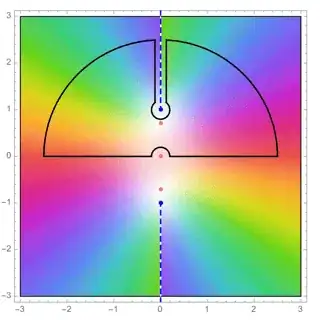

and tackle $$\oint_C \frac{\arctan z}{z \left(\frac12+z^2\right)} \, dz = \oint_C \frac{i \ln \left\lvert\frac{1-iz}{1+iz}\right\rvert - \arg \frac{1-iz}{1+iz}}{z \left(1+2z^2\right)} \, dz$$ along a semicircular contour $C$ as shown below. Pink points are poles at $z=\pm \dfrac i{\sqrt2}$ and a removable singularity at $z=0$; blue points are branch points at $z=\pm i$, and the dashed lines indicate where we take the cuts.
plot of contour
At this point we basically reproduce Accelerator's solution with some slight differences peppered in.
