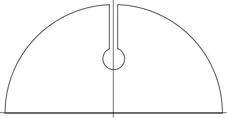

Sub $x=\log{(1+y^2)}$; then the integral is equal to
$$\int_{-\infty}^{\infty} dy \frac{\log{(1+y^2)}}{1+y^2} $$
I will illustrate how to use complex analysis to evaluate this integral. Consider the following contour integral:
$$\oint_C dz \frac{\log{(1+z^2)}}{1+z^2} $$
where $C$ is the following contour:
i.e., a semicircular contour of radius $R$ with a detour around the branch point at $z=i$ of radius $\epsilon$. The contour integral is equal to
$$\int_{-R}^R dx \frac{\log{(1+x^2)}}{1+x^2} + i R \int_0^{\pi/2} d\theta \, e^{i \theta} \frac{\log{(1+R^2 e^{i 2 \theta})}}{1+R^2 e^{i 2 \theta}} \\ + i \int_R^{1+\epsilon} dy \frac{\log{(y^2-1)}+i \pi}{1-y^2} + i \epsilon \int_{\pi/2}^{-3 \pi/2} d\phi \, e^{i \phi} \frac{\log{[1+(i+\epsilon e^{i \phi})^2]}}{1+(i+\epsilon e^{i \phi})^2} \\ + i \int_{1+\epsilon}^R dy \frac{\log{(y^2-1)}-i \pi}{1-y^2} + i R \int_{\pi/2}^{\pi} d\theta \, e^{i \theta} \frac{\log{(1+R^2 e^{i 2 \theta})}}{1+R^2 e^{i 2 \theta}}$$
Note that the third and fifth integrals are on opposite sides of the branch cut along the imaginary axis above $z=i$. Also note the limits on the fourth integral: the upper limit is less than the lower limit because the contour traverses clockwise locally about the branch point $z=i$.
We consider the limits as $R \to \infty$ and $\epsilon \to 0$. In these limits, the second and sixth integrals vanish. Rearranging things a bit, we get for the contour integral
$$\int_{-\infty}^{\infty} dx \frac{\log{(1+x^2)}}{1+x^2} - i (-i 2 \pi) \int_{1+\epsilon}^{\infty} \frac{dy}{y^2-1} + \frac12 \int_{\pi/2}^{-3 \pi/2} d\phi \, \left [\log{(i 2 \epsilon)} + i \phi \right ] $$
Note that, while there appears to be singular behavior as $\epsilon \to 0$, that singular behavior will cancel out as we will see.
By Cauchy's theorem, the contour integral is zero. Doing out the second and third integrals, we find that
$$\int_{-\infty}^{\infty} dx \frac{\log{(1+x^2)}}{1+x^2} - \pi \left [\log{\left (\frac{y-1}{y+1} \right )} \right ]_{1+\epsilon}^{\infty} - \pi \log{(i 2 \epsilon)} + i \frac14 (2 \pi^2) = 0$$
Simplifying, and taking $\log{i} = i \pi/2$, we get
$$\int_{-\infty}^{\infty} dx \frac{\log{(1+x^2)}}{1+x^2} + \pi \log{\epsilon} - \pi \log{2} - i \frac{\pi^2}{2} - \pi \log{2} - \pi \log{\epsilon} + i \frac{\pi^2}{2} = 0$$
Thus...
$$\int_0^{\infty} dx \frac{x}{\sqrt{e^x-1}} = 2 \pi \log{2} $$
Ron Gordon
  • 141,538
  • What is different between the third and the fifth integral (where do the extra terms $-i\pi$ and $+i\pi$ come from?), I know its got something to do with branch points but I don't get it! And how did you know to use this type of contour? @ron – john Jan 15 '16 at 05:12
  • @john: The $\pm i \pi$ terms come from converting $\log{(1-y^2)}$ to $\log{(y^2-1)}$ - the $\pm i \pi$ is $\log{(-1)}$. Whether it is one or the other depends on which side of the branch cut we are on. I know to draw this sort of detour in a contour whenever there is a branch point that must be avoided. – Ron Gordon Jan 15 '16 at 06:56
