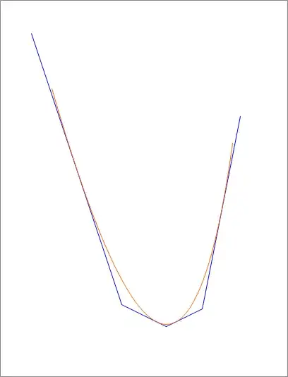

Given $4$ lines in the Cartesian plane, defined by
$$ a_i x + b_i y + c_i = 0 , \hspace{5pt} i = 1, 2, 3, 4 $$
I want to find the parabola that is tangent to all four lines.

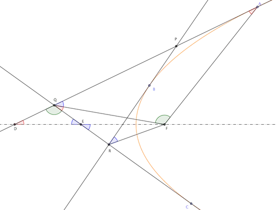

Let three tangents to a parabola be given, with tangency points $A$, $B$, $C$ and intersecting at $P$, $Q$, $R$ (see figure below). Let $F$ be the focus of the parabola, and $D$, $E$ the intersections of the axis of the parabola with lines $PQ$ and $QR$.
It is well known that $FA=FD$, which entails $\angle FAQ=\angle EDQ$. In addition, we know that (see here for a proof):
the exterior angle between any two tangents is equal to the angle which either segment of tangent subtends at the focus,
which in our case implies $\angle AFQ=\angle DQE$.
It follows that in triangles $AFQ$, $DEQ$ we also have $\angle FQA=\angle DEQ$.
But with an analogous reasoning we can prove that $\angle FRB=\angle FER=\angle DEQ$. It follows that $\angle FRP=\angle FQP$, and points $FPQR$ are concyclic as it was to be proved.
