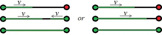

The two node case can be analyzed like this: first nothing is happening, then after a time with Exp($2f$) distribution, one node is activated. With probability $1/2$, that node was the one of interest, so we stop. With probability $1/2$, the other node was the one of interest, so now after an additional time $1/v$ we will stop. However, we can stop before that if the node just activates itself, which will happen after a time with Exp($f)$ distribution after the first activation. (Here I have exploited the memoryless property of the exponential distribution.)

We see a pattern in these formulae, but unfortunately this pattern corresponds to a star-shaped network of nodes ($n-1$ nodes connected to our node of interest in the center) rather than to a ring of nodes. A larger ring of nodes is more complicated because there are more categories of nodes. For four, there are three categories of nodes: the node of interest, the two neighboring nodes, and the node on the opposite side. So you get a schematic like
$$E[T]=\frac{1}{4} E[T \mid \text{ node of interest activates first }] + \frac{1}{2} E[T \mid \text{ neighboring node activates first }] + \frac{1}{4} E[T \mid \text{ opposite node activates first }].$$
That last term is now more complicated, because it could happen that our node activates itself, or that a neighboring node activates itself before time $1/v$ and then the wave reaches our node in time $1/v$ after that, or that no further self-activations occur and our node activates in time $2/v$ after the first activation.
