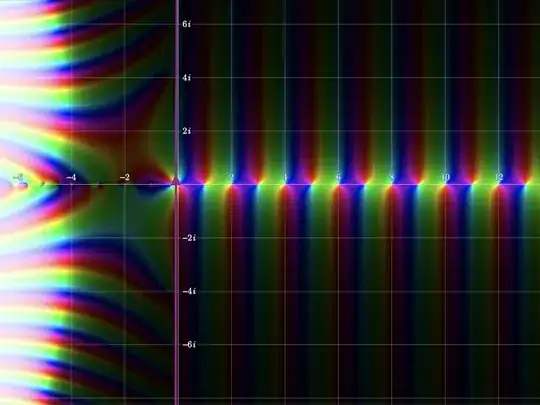

To understand why this function has cannot be extended to a single compelx function, let us look in the complex plane. The function for us to analyze is $\zeta(-(2z+1)x) \frac{\csc(\pi z)}{2i}$. At the integers, this function has the residue $(-1)^k \zeta(-(2k+1)x)$. If these residues were all of the residue of the function, we would have a function that could be analytically continued to the whole plane. However, $\zeta(-(2z+1)x)$ contributes its own residue because $\zeta(1) = \infty$ and moreover the position of this residue depends on $x$. Indeed, the residue is located at $-(2z+1)x =1 \implies z = -\frac{x+1}{2x}$ and has value $\frac{\pi \csc\left(\pi \frac{1+x}{2x}\right)}{2x}$.
Now, observe the following contour integral $$\int_{c - i \infty}^{c + i \infty} \zeta(-(2z+1)x)\frac{\csc(\pi z)}{2i}dz $$ Here is a graph of what the contour integral looks like when $\mathfrak{Re}(x)<0$ enter image description here Notice that when $\mathfrak{Re}(s)<0$ the $\zeta$ residue is on the LHS of the contour, so we obtain that $$\int_{c - i \infty}^{c + i \infty} \zeta(-(2z+1)x)\frac{\csc(\pi z)}{2i} = \sum_{k=0}^\infty (-1)^k \zeta(-(2k+1)x) = T(x)$$ However, and this is crucial, we can switch the orientation direction of the contour (i.e. go from $-\varepsilon + i \infty$ down towards $-\varepsilon - i \infty$ instead of traveling upwards) and now the integral is also equal to $$T(x) = \int_{c - i \infty}^{c + i \infty} \zeta(-(2z+1)x)\frac{\csc(\pi z)}{2i} = -\sum_{k=1}^\infty (-1)^k \zeta(-(-2k+1)x) + \mathbf{\frac{\boldsymbol{\pi} \boldsymbol{\csc}\left(\boldsymbol{\pi} \frac{1+x}{2x}\right)}{2x}}$$ Now, notice what happens when we switch the sign of $x$ so that $\mathfrak{Re}(x) > 0$. Then we obtain that $$\int_{c - i \infty}^{c + i \infty} \zeta(-(2z+1)x)\frac{\csc(\pi z)}{2i} = -\sum_{k=1}^\infty (-1)^k \zeta(-(-2k+1)x) = T(x)$$ and as a consequence $$T(x) = \int_{c - i \infty}^{c + i \infty} \zeta(-(2z+1)x)\frac{\csc(\pi z)}{2i} = \sum_{k=0}^\infty (-1)^k \zeta(-(2k+1)x) + \mathbf{\frac{\boldsymbol{\pi} \boldsymbol{\csc}\left(\boldsymbol{\pi} \frac{1+x}{2x}\right)}{2x}} $$
Now, altogether, this tells us that $T(x)$ has a branch cut on the line $\Re(s) = 0$ since we have that $$T(x) = \sum_{k=0}^\infty (-1)^k \zeta(-(2k+1)x) + \begin{cases} \frac{\pi \csc\left(\pi \frac{1+x}{2x}\right)}{2x} & \mathfrak{Re}(x)<0 \\ 0 & \mathfrak{Re}(x)>0 \\ \end{cases}$$ And so $T(x)$ is part of two different branches of the same Reimann surface.
Now, let us analyze more closely the behavior of the contour needed to make our sum converge. $\zeta(-z)$ becomes large when $\Re{z}>0$. Thus $\zeta(-e^{i \theta}z)$ is large between angles $-\frac{\pi}{2}-\theta<\alpha<\frac{\pi}{2} - \theta$. Therefore, our contour should be integrated on the following path $$\int_{-\infty e^{(-\frac{\pi}{2}-\theta)i}}^{\infty e^{(\frac{\pi}{2}-\theta)i}} f(z)dz$$ However, this contour breaks down when $\theta = \pm \frac{\pi}{2}$, i.e. exactly when $\theta$ is purely imaginary. In that case, we need to integrate along the real line, but this is where all the poles are, and we can't integrate over poles (the integration doesn't even converge in the principal value sense, since the series doesn't converge). Therefore, we are forced to analyze the sum. When $s$ is purely imaginary then $$\sum \frac{1}{n^s + n^{-s}} = \sum \frac{1}{e^{\ln(n) i t} + e^{-\ln(n) i t}} = \sum \frac{1}{\cos(\ln(n)t)}$$ Which suggests there are poles at $t = \frac{\pi + 2\pi k}{2 \ln(n)}, n,k \in \mathbb{N}$. Though, at the moment, I can't think of a good way to show there are actually poles there.
