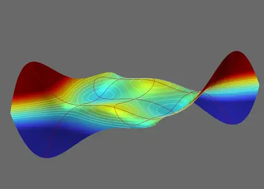

For those interested: Bezout's theorem tells us that for a real quartic polynomial in two variables you can have at most $(d-1)^2=9$ critical points. This is one such polynomial: $$(y^2 - x^2)(y^2 -xy + x^2)+x^2-y^2$$ and a plot below where the red curves are the loci of the zeros of each gradient component. Where they intersect you have a critical point. Plot of the polynomial <span class=$$(y^2 - x^2)(y^2 -xy + x^2)+x^2-y^2$$" />
