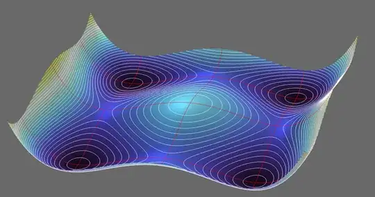

$$p(x,y)=(8x^4-8x^2+1)+(16y^4-12y^2+1)$$
The OP gave a simpler polynomial on this form but I like this one since it is the sum of two Chebyshev polynomials.
Below is a plot of this polynomial where the red curves are the loci of the zeros of the gradient components. Where they intersect we have a critical point.

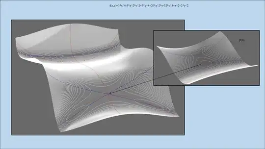

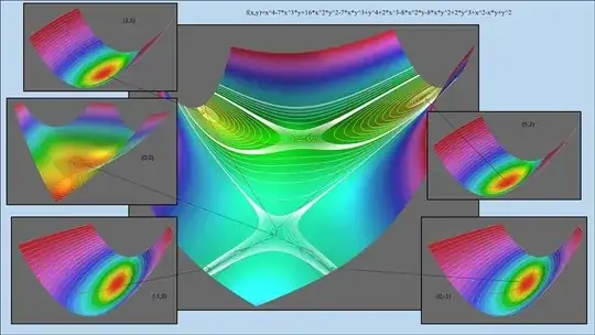

Finally, the cross-posting: https://mathoverflow.net/questions/442736 features a few polynomials with 5 minima. Below is a visualization of one of the polynomials, discovered by Peter Mueller:
Polynomial with 5 minima and 4 saddle points.
Note: the plot for (0,0) is rotated 180 degrees vs. the larger figure and some of the others are also rotated.

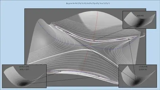

Here is a visualization of a simpler polynomial, found a bit later by Peter Mueller:
Polynomial with 5 minima and 4 saddle points, irrational coords.
Note: The coordinate values are rounded and the orientation of each highlighted minimum has been changed for clarity. In this case the symmetry of the polynomial was used to show the nature of the minima (only 3 types). (The previous polynomial is also symmetric with 3 different types of minima but there all 5 are shown separately.)

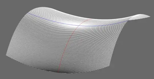

Here is a zoomed-in view of the centrally located saddle point (located at the origin):
Central saddle point.

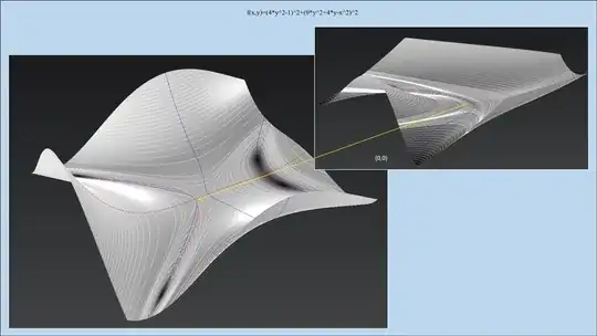

The following visualization shows a polynomial written as a sum of squares with an interesting minimum at the origin (Mueller): Sum of squares polynomial with interesting minimum.
Note: This doesn't look like a minimum but it is! There are shallow saddle points on either side of the minimum.
